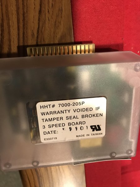

    Unfortunately, it "appears" to be the control box......unless there is a wire or something off somewhere.

    I think you’re right. One thing we did notice is that the connection that the control board slides into, that blue seat is not secure. We’ll need to remove the back again to see what the deal is so will also check every connection when we do. Thanks much for all the help folks!

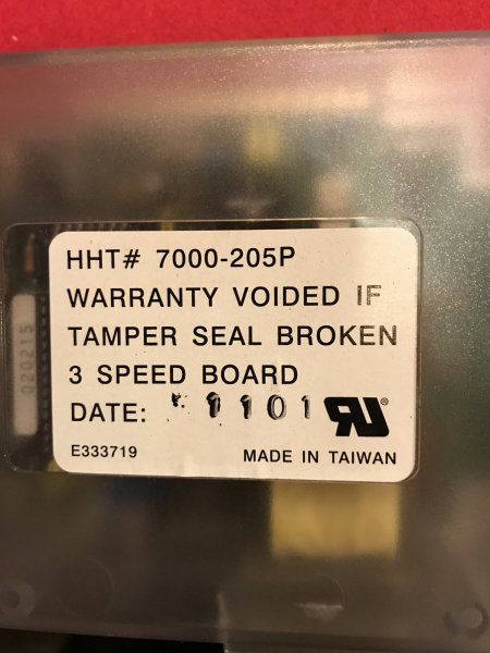

  15. corkman
    corkman
    Nov 12, 2015
    292
    1,241
    Southeastern mass
    I have a spare board that came off a cb1200 insert that I could send him to try. Is this compatible with his stove

  16. slvrblkk

  17. slvrblkk
    slvrblkk
    6,647
    29,535
    Northampton, PA
    Yes it is!

  18. slvrblkk
    slvrblkk
    6,647
    29,535
    Northampton, PA
    It will need to be set on #4 setting for the Contour

  19. corkman
    corkman
    Nov 12, 2015
    292
    1,241
    Southeastern mass
    Terry. I sent you a PM

  20. Terry Johnson
    Terry Johnson
    Oct 27, 2019
    18
    34
    Minnesota
    Replied!
