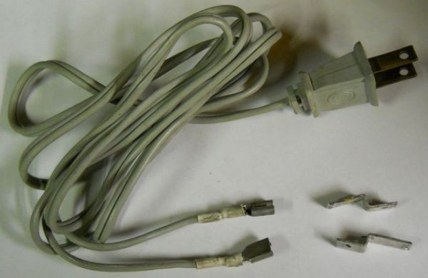

    as we mentioned before, you probably have to connect the 2 stat connections together if you didn't get a one yet. Otherwise, the control board thinks you're not calling for heat.
    If you want to make sure the auger motor is working, try making a power "jump" lead to put 120V to the motor directly. Make sure stove is unplugged before you do that, and remove the power connections from the auger motor first too. A lot of us have made something like this out of an old lamp cord to do testing of auger motors, blowers, etc:
    IHATEPROPANE and will711 like this.
  12. tammysteve1971
    tammysteve1971
    Sep 3, 2017
    106
    254
    Doing that now lol

    Also, if the front door isn't sealed (broken or missing glass), there is probably a vacuum switch that won't close to turn the auger on.....hence the need for the power jumper I mentioned above.
    Most pellet stoves have this saftey feature so the stove won't continue to feed pellets if the door is left open or there is a large vacuum leak. The exhaust blower must cause a low pressure in the firebox to allow the auger to run.
