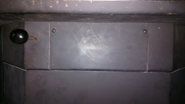

    When you look at the front of the stove with the ashpan removed, there is a small access "door". Remove the two screws and take that door off. The igniter is attached to the bottom of the burnpot.

    There's linkage attached to the pot and the igniter....you'll need to unhook that stuff before you remove the pot
    IHATEPROPANE and imacman like this.

  10. slvrblkk
    slvrblkk
    6,647
    29,535
    Northampton, PA
    The access door I just mentioned.

    Found the wires we need to unhook
    Sent from my SM-S820L using Tapatalk

    Behind that door you'll need to take the "R" clip off the linkage and take the igniter off the pot. It's a little tricky but you'll get it.

    You can or as you're pulling the pot out just leave the igniter lay in there
