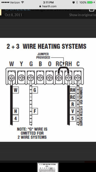

    Here is the Lux wire diagram
    Connect one wire to RH (Means Red for Heat)
    Connect the other wire to W (Means White wire)
    Connect other end to back of stove (Does not matter which wire goes on which screw terminal)
    You have to take the back off the T-Stat to see the RH and W screw terminals! LOL
    Click diagram below to Enlarge picture!
    Pic 1 - Lux T-Stat wire diagram for Pellet Stove

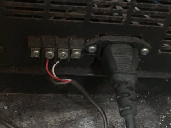

    Pic 2 - T-Stat terminals on back of CB1200 next to power cord.

    As you're looking at the back of the stove, on the lower left hand side, there is a terminal block next to the plug for the stove. That's where the thermostat gets hooked up to.

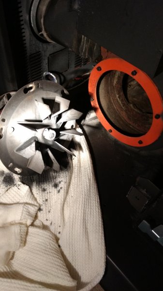

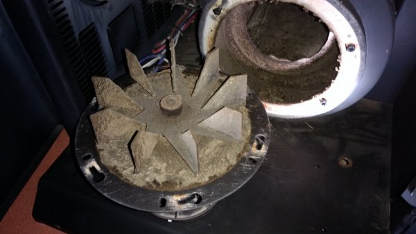

    IMG_20170903_145645973.jpg A little cleaning on the exhaust fan and a new gasket .

  18. Russell
    Russell
    Sep 9, 2015
    1,166
    5,631
    South Coast , Massachusetts
    I just added the after pic.

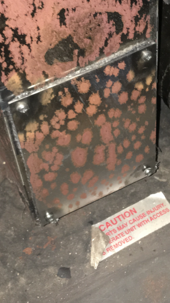

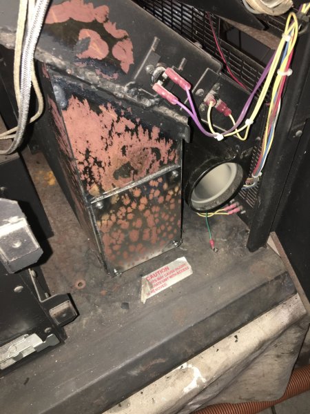

    Also on the right side of the stove, take the 4 screws out of the exhaust chamber cleanout cover and take it off and cleanout all the ash. My stove was full behind this cleanout cover!!
    See pic
