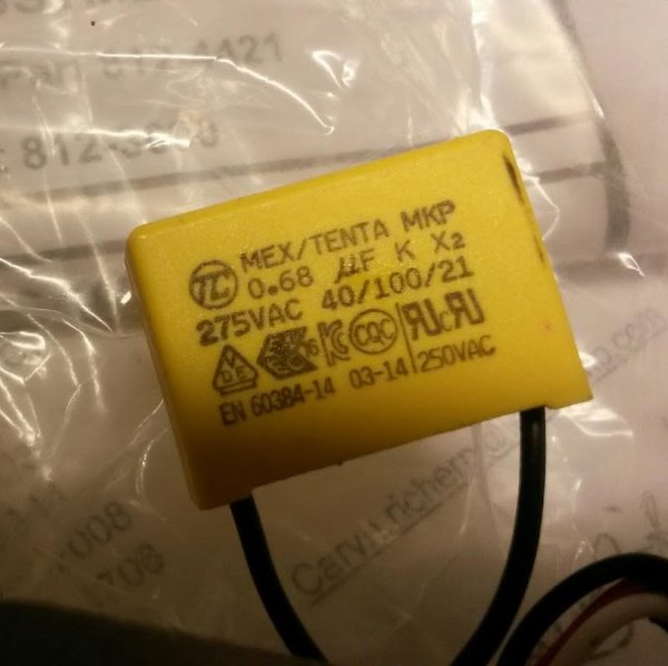

    I pulled the control box cleaned a ton chit out.. switched to 4 from 6 (why not at this point)
    I get great start up fire - now get proof of fire red light.. - I hear & see auger motor shaft engage, but now pellets stop drop when I get into past initial fire.
    I'm fixing to pull the dang auger now... but it drops plenty for ignition fire.
    jtakeman likes this.

    What is the yellow in first picture? is it connected to auger motor?
  13. badbob
    badbob
    Apr 23, 2014
    2,482
    9,947
    Sure looks like a burned up auger motor capacitor
    PoolguyinCT likes this.

    Yes it is -- by why dropping fuel at ignition sequence.. that is what has me scratching my coconut

    Yea they can cause weird problems.They make a plug in kit for them.

    9,947
    The part number is srv230-1920,but if you cannot get one fast,here is the newer specifications,electronics places have them. VWtRlwa-H54rcXcNUVL3rGxo0FAGG1y1A3y0hB-EPoG-RXEXFGcoi81n_i_0pW2NNIxbYhxs=w1024-h674.jpg

    Cool - is could my auger be reversing between start up & heat fires, hence only start up pellets ... I swear next house natural gas!!!

    Thanks for the electronic store top.,
    This is my old dead shot auger motor... is there a play? For a capictor switcharoo ?[​IMG]

    there was a complete kit,motor,harness and all,then later just the capacitor harness.You could crimp in your old cap to see if it works,but that might have been a problem with your other motor.Will leave some reading info. Wiring for feed motor on Quadrafire Castile Pellet Stove
