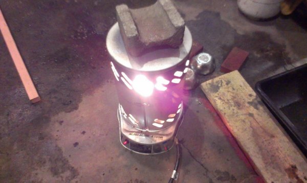

    Well I have an 80000 btu heater in my garage http://www.amazon.com/Mr-Heater-Propane-Convection-MH80CV/dp/B0000C6E2Z and I am experiencing g some interesting things this year.in the past I could get the garage to 35f no problem in the bitter cold but the doors where not insulated. I just finished insulating the doors and with it being 15f out today I fired it up and in about an hour it was 47f. Not bad but not good enough for my liking!the tanks are 20lb tanks and they are freezing fast and slowing down the heater a bit so the flame is too small. I am pretty sure the tanks are way undersized for my heater so I have been looking at 100lb tanks. What I have been reding has me a little confused. The 20lb tank can't feed the 80000 lb unit fast enough to keep it throwing heat where a 100lb or bigger can. Why is this? Is it volume related or pressure related or both? My thought is to buy a big 200is pund tank and set it outside the garage then fill it every couple months because it isn't all that expensive for what I'm doing.
    Thanks fellas in advance.

    I'd definitely go the 200 route. I am carrying 2 -420's on my back-up system. It is a volume thing for sure.

    When it is cold a 20lb can't turn the liquid propane to gas fast enough for your size of heater. If you can keep the tank warmer it may do a better job. I have set them in front and off to the side of salamander type heaters to help keep the tank warm. To close and it may go kaboom!

    As the volume drops so does the pressure. A 100 lb tank has higher volume (obviously) so it will be able to maintain the same pressure longer.
    Cold temps only exacerbate the situation as the propane contracts and further lowers the volume. It also doesn't help that when gas expands it cools...a LOT.
    You could either increase volume or increase temperature to maintain pressure.

    It's not really losing heat it's freezing the tank and slowing the flame down in the torch.

    The tank needs surface area to vaporize the liquid into the usable gas. Short fat tanks feed bigger heaters

    Simple question is your regulator covered ? Just an ice cream pale over the regulator will prevent the regulator from freezing .
    It has been almost 40 years since we heated with propane and just a bucket over the regulator would keep it functioning in cold weather .
