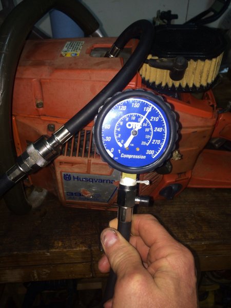

  4. foragefarmer
    foragefarmer
    1,479
    4,567
    Central, Virginia
    This doesn't hurt either.
    Well it hurts to pull over.
    Moparmyway, mdavlee, cnice_37 and 2 others like this.
  5. mdavlee
    mdavlee
    Oct 21, 2013
    4,380
    10,479
    That's pretty normal compression for them with a gasket delete.
    Moparmyway and foragefarmer like this.
  6. foragefarmer
    foragefarmer
    1,479
    4,567
    Central, Virginia
    With the gasket delete squish was still .028. Is that normal?
    Moparmyway likes this.
  7. mdavlee
    mdavlee
    Oct 21, 2013
    4,380
    10,479
    Yes.
