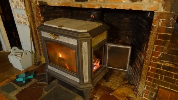

  9. Flamestead
    Flamestead
    Dec 7, 2013
    2,167
    10,973
    Windsor County, VT
    I've had 3 different stoves on this setup within the past 5 years. One was a top-loader (fireman, I think we should rule these top-loaders out. I think there is magic involved (always amazed me that it did not smoke)). The other two were the PH and the IS. We ran the IS for about 7 cord with the smoke flapper locked in the up position without any smoke trouble, and the PH with a door much smaller has never been a smokey stove for us.
    I just loaded the PH half-full with punky wood onto a good coal bed and then left the door wide open and got the camera. Then fumbled around for a while for the right low-light setting.
    Sorry for the dirty glass. This is 2 minutes after half-filling (40 outside and no wind). I didn't see any smoke escape, but my wife says 'phew'. So two minutes of the door wide open after loading failed the wife test. Under normal operating we have no smoke issue. But we have a pretty good draft.
