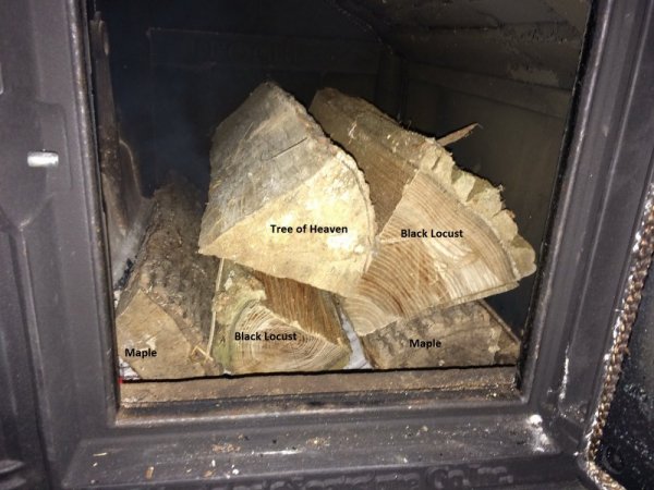

    Here's a pic from Saturday nights overnight load, about 1/2 full. This gave me an easy 12 hour burn, still hot stove in morning, plenty of red coals for reload...
