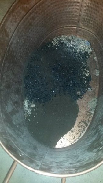

    Well folks, I figured out why I've been having draft and smoke issues. The elbow to the flue was 3/4 plugged. Now I'm back in the game. Next year I'm going to try and get some insulation in behind the liner to avoid this kind of buildup. It's an outside chimney.
    Just a friendly reminder to do your chimney maintenance. This time of year starting fires more often creates more buildup.

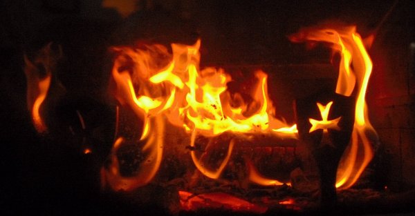

    A good friend near Albany NY got his new Ideal Steel home from Woodstock and installed last weekend. He's very happy with the stove so far. He chose a Crusaders shield theme and just sent a pic of his andirons illuminated by the flame:

    3/4 plugged is a bit scary. I installed a damper in late Dec and have been burning (very successfully) with it fully closed except on start-up. I am going to remove the damper and inspect it as soon as we have consistent nighttime temps near freezing. I'm a bit anxious to see if there is build up on the damper. I figure that it is the most likely place to be a problem, as I always have had the most (little as it is) soot in the chimney at the 30's where the pipe angles back to enter the chimney. I think any obstruction creates some accumulation.
