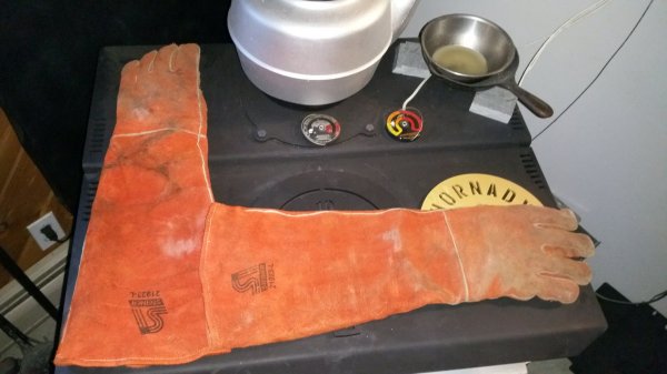

    I didn't buy these just because there cool. 1426286491101.jpg There necessary!
    Brad38 and My IS heats my home like this.
