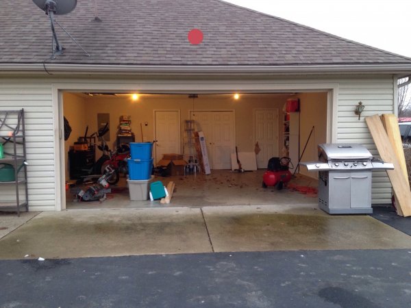

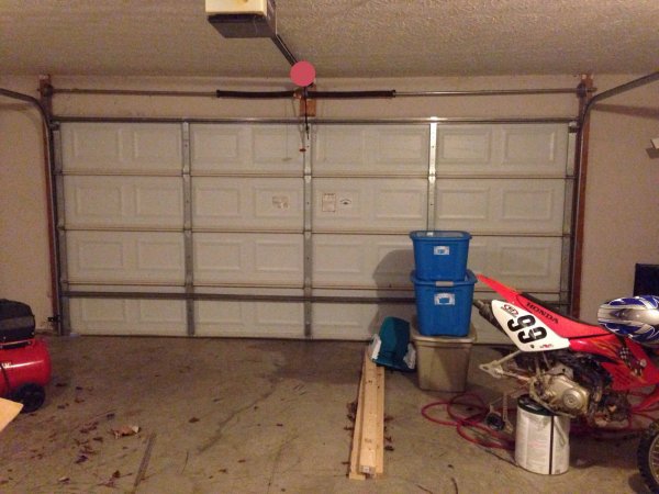

    Thanks for the set-up info! Not trying to hijack this thread, but you guys said its slow right now anyway. :) I'm having a garage conversion done in 8-10 weeks. The red dots in my pics represent where the stovepipe/class A will be. Thanks to the advice given on a separate thread I started, I'm pretty sure I'll be going with top vent/double-wall stovepipe/rear heat shield. Woodstock recommends at least a 15' collar-cap height per the IS Manual. I'm kinda concerned, since that means a tall class A out of the 7/12 roof. (About 9'!) I realize that will probably be necessary though in light of where I've decided to have the stove installed. (Edge of roof) someone suggested I call Woodstock and speak with them about it, which I probably will. Of course I will adhere to the 10-3-2 rule. (I bet 9' will do it! Lol)

    Would it be possible to put it on the l/h wall center closer to the peak in the first pic?
    How much Class A will be in the attic?
    Oh, if you want a very easy install and can swing it, get the telescoping doublewall stove pipe.
    So easy, even a caveman (or me) can do it.
    concretegrazer and Brad38 like this.

    Unfortunately not. We're opening up that area of the wall as an entry into our living room. (Which is on the other side of that wall.) you're correct- that would allow a lot more class A in the attic in that location. I'm thinking in the current proposed location, I'm only looking at 12-18" of attic space. (I haven't measured, but that seems about right given the proximity to the end of the roof.) And telescoping stovepipe it is! This caveman needs all the help he can get! Lol.
    papadave likes this.

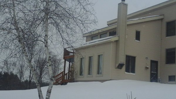

    Brad 38, I built a chase over my Duravent chimney like your pic, so since I did mine before I found this club so I did thru wall. The clean out t makes cleaning or checking pipe 1 minute job. But I would recommend if you build it put rigid insulation on under vinyl. To insulate the chase. My chimney is 26 feet cost about 150 in materials 200 in labor. I intend to build a trap door to finish bottom this spring. 20150220_074034.jpg
    concretegrazer, Brad38 and milleo like this.

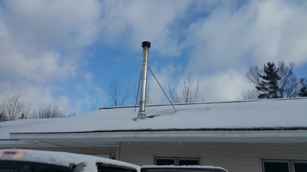

    My insurance company said I had to have a chase and my wife agreed!:whistle: We are in a high wind area.
    Brad38 likes this.

    Thanks for sharing! How tall is that?
  19. Hollywood
    Hollywood
    Oct 1, 2014
    228
    381
    Right around 10ft above the roof.
