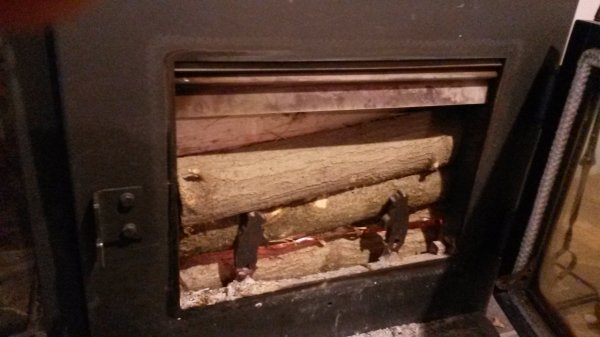

    The box elder is a go. This should be interesting...
