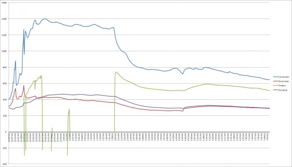

    This is last night's graph. It has two flaws: the first is that the firebox thermocouple is failing (again) and that is why it cuts in and out. The second is that I happened to be walking by the stove at 4:30 AM or so and bumped the draft to 1/2 open; this can be seen on the graph where the stove pipe temp. increases above the stove top temp. due to more air going through the stove.
    That said, note the stove top temp. between, say, midnight and 4:30 AM: a more even burn with flatter stove top temps. due to the introduction of a little bit of air under the grate to directly engage the coals.
    And by the way, it was 6F this morning outside, the inside was 73F.

    Now to get a tougher thermocouple for the firebox!
    Brian

    It looks like the cat had a long plataeu in this graph. You can't complain with those results

    How are you keeping the stove top temps so low?
