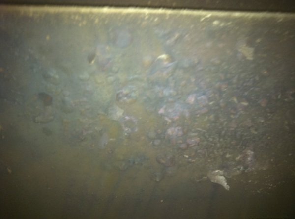

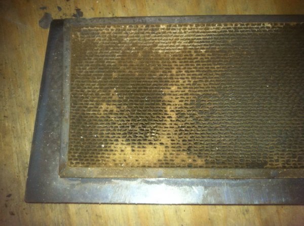

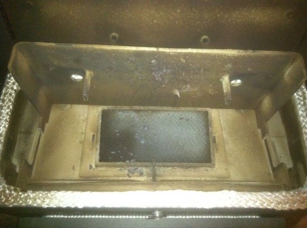

    I had some warmer temps this afternoon so I let the stove run out, when it was cool this afternoon I took a peek to see how things were (it's been about a month since the last check)
    The first pic shows that I'm catching up with some of you, pieces of scaled steel have fallen on top of the cat. As I know some of you have had much worse scaling than this, the following pic of the cat had me more concerned.
    This is the scaling of the bottom side of the radiator, hard to see the actual chips straight on.
    This is the underside of the cat, the side that faces down towards the stove. The top right hand corner (as it sits in place) had some buildup covering the cat's 'honeycomb'. It was brownish in color and sort of cakey looking. It brushed right off without any problem, turned to dust when I blew some air through it.
    This is all the parts returned to the sled. As I'm shooting the picture downwards you may be able to see the bypass rod (closest to the gasket) has warped. It's hard to see any curvature in this pic but to the naked eye it seems more significant.

  10. JA600L
    JA600L
    Apr 3, 2014
    762
    1,702
    Lancaster, Pa
    What is plugging your cat? I didn't see that.
  11. My IS heats my home
    My IS heats my home
    Dec 1, 2013
    7,394
    17,655
    Albany, NH
    Not sure. I uploaded the pics from the iphone first and then typed the captions to the pics on the ipad.

  18. BDF
    BDF
    Jul 22, 2014
    2,160
    7,533
    Virginia
    Wow, that is a fair amount of ash in that combustor after a month of running. Mine was very clean a couple of weeks ago after running the stove 24/7 since Oct. Wonder why yours is doing that?
    Just thought of it: I did have a lot of very fine fly ash above the combustor.... makes me wonder if my combustor looked like yours but my draft inducer sucked it through the cat.? That thing does create quite a bit of air movement and I do occasionally use it with the bypass closed. Hmmmmm.
