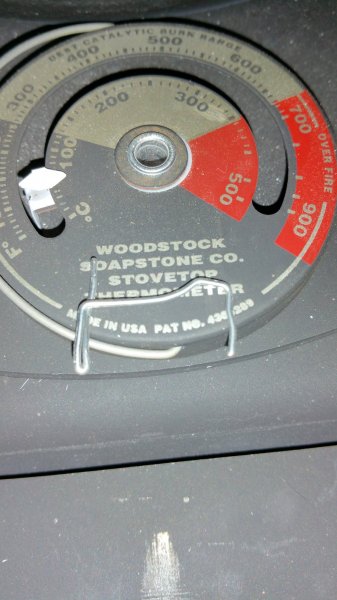

    Here is my early first review of my new Woodstock Ideal stove.
    Been burning for seven days mostly high teens at night and mid thirty daytime temps.
    Had one day, Sunday that hit fifty and rainy, did not notice much difference in the burn.
    A little about my setup, running 8" Dura vent, 15' straight up, heating 2200 sq. ft., the stove is exactly in the middle.
    It is in between bedrooms in the back and living areas in the front, Its a one floor rambling sort of ranch house.
    I am burning 4 year seasoned, covered, mostly oak, from a score of tree tops left behind after a lumber cut.
    So they are not able to pack in real tight, some kind of of curvy and odd sized splits.
    I am getting the 12 to 14 hour burns as advertised by Woodstock, loving it.
    The stove is so predictable, rake up the few coals left after the burn to the front.
    Pack the stove to the top, blow on the coals and instant light off.
    15 minutes later front temp at 300, engage the cat, 20 minutes later slide air control to closed.
    And I am good for 12 to 14 hours.
    Running a front stove temp of 350 down to 250 degrees at the end of the burn cycle.
    Pipe temp about 300 degrees dropping during the burn to about 200 after about 5 hours
    The stove room stays in the low 80's the other rooms in the low 70's.
    On wakeup the stove room is in the mid 70's,other rooms in the mid 60's.
    I love this stove!!!
    Because this is the only source of heat we use, Had to just do a 24 hour turn around time from the old to new stove.
    My plan is to rebuild the current hearth and go to a 6" vent, this summer.
    I don't really know what's under my current hearth just the tile or a cement board of some type.
    The old fire breathing Defiant sat on it for 35 years with no problems.
    So I set it up on the cement pavers, just in case and to be in compliance.
    One thing that is odd is that at no time do the pavers even get warm.
    About the only thing I am going to work on is I can't seem to throttle her down as much as I would like,
    during the first few hours, possibly the 8" vent, I love a challenge, spent 35 years in automation design.
    Not having any coaling issues at all.
    All in all I can't see much changing in the stove performance from now on in.
    I do think this stove will change my 10 year supply of firewood into a fifteen year supply.
    A bit long I know, sorry.
    In its new home.

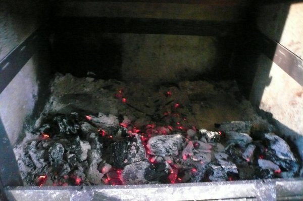

    The end of last nights 14 hour burn

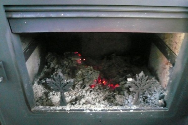

    Coals raked forward

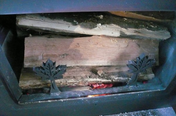

    Packed up and she's off.

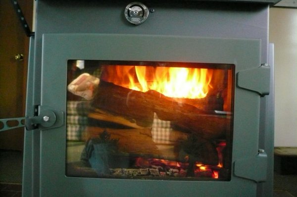

    15 minutes later cat ready to engage
    So easy a cave man can do it!

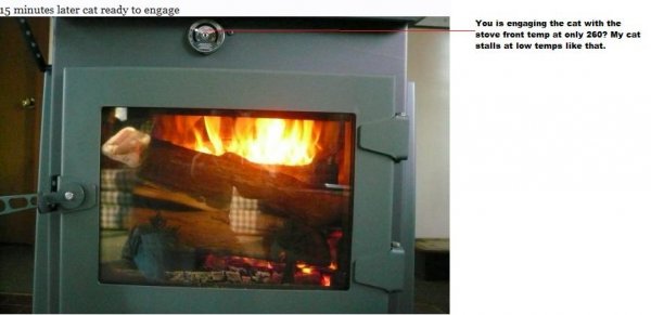

    cat.jpg I'm lost on reloading...

    Yeah it takes right off okay, haven't stalled it yet I think, my first cat stove so just following Woodstock's info.

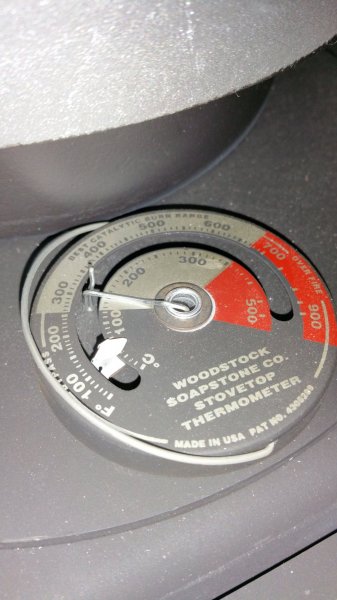

    Enjoyed your early review Chestnut, and if the paint is fully cured yet might you be interested in putting the magnetic thermo just to the right of the cat port on the front, up high? I wonder about your post saying it read 350° there when some of us have seen the (right) front thermo hit 750° or better a couple hours after cat launch. You have a good- looking setup there. I wonder what you think once you take it out of third gear... heheh.

    Well, I am burning [less than 1 year old oak] and can reload and re- light the cat. pretty easily. I do not have a thermometer on the front of the stove but the one on the top of the stove is often well below 300F when I reload and the combustor lights right off easily.
    For what it is worth, this stove will run very low temperatures without actually stalling the cat. In warmer weather, I commonly had my stovetop below 300F with the cat. below 850F and burning 100% of the visible smoke coming out of the firebox. What I am trying to say is that a cat. can be lit, active and working perfectly without putting out much heat. The keys are 1) the temp. at the top of the firebox 2) the amount of air moving through the stove (small draft settings really help in lighting the cat., this is not intuitive but it is the case) and 3) that the wood is either dry enough (and mine is around 20% or a bit more, not 'bone dry' for sure) or has charred enough to no longer be putting out much water vapor.
    Try getting the whole load of fuel involved and a fairly hot fire going such that you cannot sit in front of the window w/in, say, 18" of the stove. Then shut the air down in two stages, once to 1/4 draft, and perhaps 10 minutes later, down to 3 notches; the flame will disappear entirely but the wood will continue to gas (it will pyrolyze: burning slowly with no flame) and the combustor will continue to burn the woodgas.

    Do you mean on the front of the stove on the opposite side of the cat port where it is now in my picture?
    If I open her up it will drive me out of the house, this thing can pump out some heat.

    Posts from the IS beta testers and owners this year indicate the hottest surface is the front above the door just right side of the cat port. Indeed, the rare time or two I saw the stainless canister under the cat glowing, the right side glowed and not the left side.

    Okay I have it there now, going to check it out thanks, I have been putting the little pieces of kindling on the right side seem to light off there.
