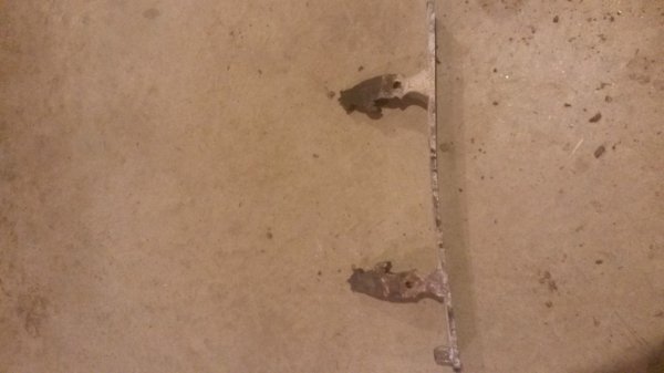

    So I usually don't mess with the andirons, but today I did. They seemed tight. Sure enough it is warped. I'm glad I could still get it out. I inspected the firebox. Everything else looks prefect. I think this may be victim to the harsh elements of burning down my locust coals. It should be an easy fix.
