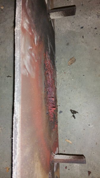

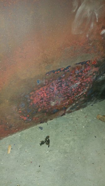

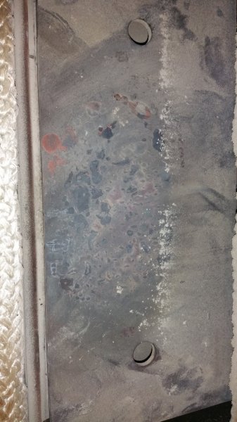

    Anyone checked the cat deflector plate? Top was covered in white dust with slight blistering and the under side was blistered and had small stalagtites/mites depending on how you look at the plate. 20150102_173047.jpg 20150102_173005.jpg 20150102_173032.jpg 1420238667445.jpg

    Hollywood , I had mine out a little over a week ago and it looked nothing like yours.
    Have you considered reaching out to Lorin with your pictures?

    Plan on it. Just lifted the hood to look around. The stuff chipped off fairly easily.

    Is the steel plate pitted?
  5. Hollywood
    Hollywood
    Oct 1, 2014
    228
    381
    Nope. It is more like there is a build up. Reminds me of a bad blistered sun burn.

    Mine has a heat signature where the cat's heat hits the plate but no other marks.
  7. Hollywood
    Hollywood
    Oct 1, 2014
    228
    381
    It looks like paint blisters but any paint on it should have been gone long ago. The max surface temp I've had it was 650* on the flue plate.
  8. My IS heats my home
    My IS heats my home
    Dec 1, 2013
    7,394
    17,655
    Albany, NH
    The cat temps would have been well over 1000 deg at times

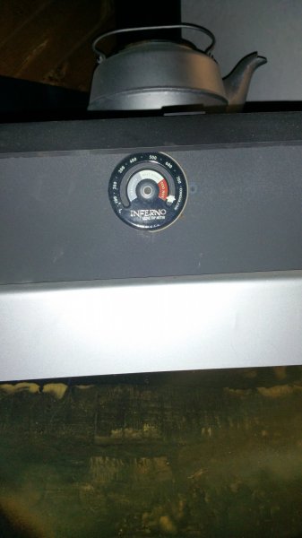

    Yup. This was the reading when I had the 650* temp up on the flue plate. 20141231_233936.jpg
  10. My IS heats my home
    My IS heats my home
    Dec 1, 2013
    7,394
    17,655
    Albany, NH
    I don't think I have ever had mine that hot on the stove front. I've been to 700 a few times but I'd knock it down because it was burning too hot too fast.

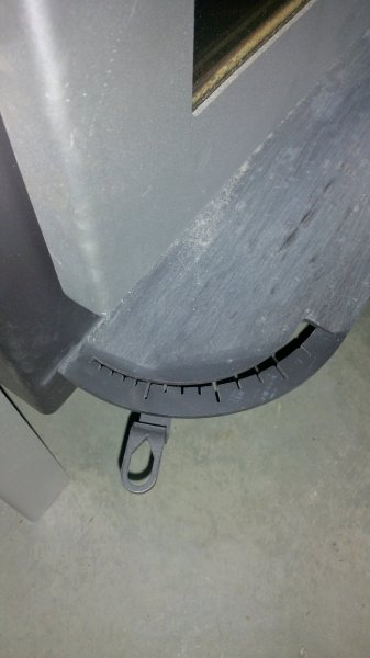

    I had draft set here when I got these Temps. 20150102_185125.jpg Wen I saw how hot it was I closed it until the Temps started to drop.

  15. BDF
    BDF
    Jul 22, 2014
    2,160
    7,533
    Virginia
    Hehehehe The brand name on the thermometer is "Inferno" and you have it almost past the extreme end of the red zone. That right there is funny. :)

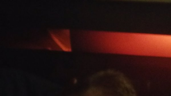

    The bottom of the radiator is likely to suffer pretty quickly compared to anyplace else on the stove just because of the extreme temperatures combined with any excess oxygen added by the cat. air feed. Steel deteriorates rapidly as the temp. increases and that is the hottest part of the stove, excepting perhaps the combustor itself. And the combustor and the bottom shield below the combustor are stainless steel, which holds up far, far better than carbon steel at elevated temperatures.

    That's what I was thinking too Brian. I kind of think of the radiator in the IS as similar to the sacrificial anode in an electric hot water tank. They made the radiator heavy and thick to take a lot of abuse from the extremely high heat (and oxygen) coming off the cat to protect the cook top. I don't think the Progress Hybrid has a similar radiator because its cook top is cast iron?
    When I was at Woodstock this past spring, someone mentioned taking out the radiator on rare occasions when they wanted higher temps on the cook top. But I don't think the cook top assembly was designed for a steady diet of that.

    I can see the top lid and the burners turning cherry red and the lid possibly warping if abused enough.

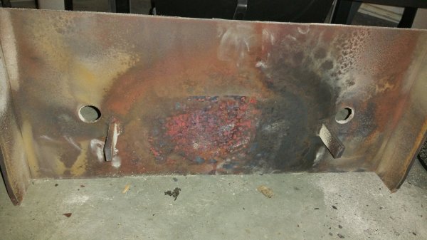

    Would love to be able to see the cat whengaged the bypass plate looks like this. 20141230_220330.jpg If a 1/4 in steel plate is orange what does human hair thickness stainless steel look like?
    Gark and My IS heats my home like this.
