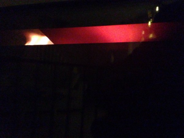

    1,454
    Bradford, Vermont
    Well this is a new one. Stove is full with the stovetop sitting at 550F. The only flames are rolling secondaries completly BEHIND the cat! It's been going like this for over 1/2 hour now.

    I still have yet to see that on mine. Nice glow in your pic

    Have not seen that on my own stove but someone else mentioned it I believe. Probably happens when the firebox is well engaged, producing a lot of gas, and the draft is set very low. The only appreciable source of oxygen is the cat. supply (or the 'bell ringer' as we know it :)) so the wood gas can only start to burn on its way into the cat.
    Nice photo and probably interesting to watch but you're gonna' need some mirrors when company stops by 'cause not everyone can lay in the same place on the floor to watch....

    I have the flames directly in front of the cat almost nightly. This was the first time they were hanging out entirely behind it. First time I ever had any appreciable smoke from my chimney too. After the picture I opened the air control an inch and the secondaries lit immediately and stayed on until I went the bed. I imagine if that sled mechanism was ever going to bind up it would have happened last night!

    Wow, I am surprised the stove was putting out any smoke with a combustor that hot.... and it was very hot to get the shield that color.
    Just curious but which flapper valve are you currently using on the stove- the original ('Old Clanger' as I call it ;)) or the new, padded one? The reason I ask is that it seems like the new padded one <may> not let as much air in as quickly as the original one did.

    Yeah I didn't quite understand it since stove top temps were not very high. Stack temps were hotter than usual with the cat engaged.
    I do have the new, felt valve. I must have a hyperactive cat.
