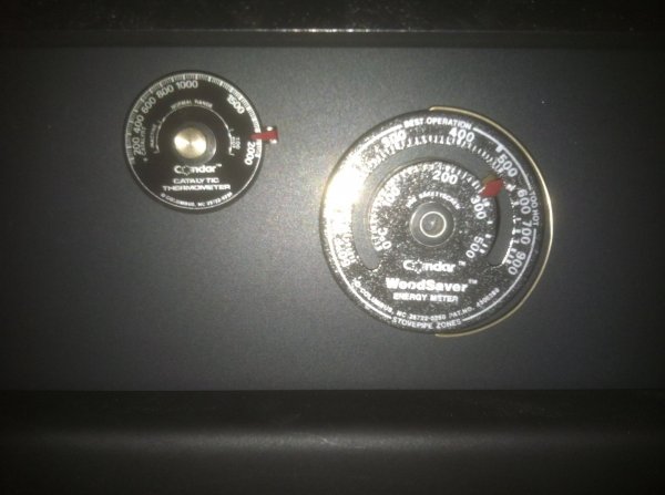

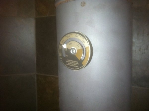

    Top pic shows a cat temp of 1800 and surface temp of 525. Flue temps on pic below are a cool 250.
    I reloaded the stove with 5 pieces of ash, firebox is black, air damper is at 1/4 less 1 notch.
    I'm wondering if the 1800* is too hot for the cat?

    Having had both one of those mechanical cat. thermometers as well as an electronic thermocouple in the same stove, my guess is that the cat. is not really at 1,800 F. Probably more like 1,600F (at a wild guess) or a bit less. 1,600F is not too hot for a cat. to maintain IMO or even more. I believe the upper limit is suggested to be around 1,700 or 1,800F but that is tough to sustain IME. You can always tip the top of the stove up just a tad and take a look: 1,800F would be quite bright yellow, well beyond red and even orange. As long as the cat. is not hotter than dull orange, I would call it 'good'. And the S.S. cat. in the I.S. cannot crumble or spall like the ceramic ones do so thermal shock is not much of a worry either.

    Did you have any communication with the folks at Condar that would make us believe that the bimetal coil, which is the temperature measuring mechanism of that type of thermometer, is calibrated to the length of the stainless steel probe. And could cutting the probe shorter cause the bimetal thermometer mechanism to now read temperatures higher than actual? Explaining your 1800* reads?

    I had thought of the same thing but never inquired in my initial correspondence. At the time I was assuming that I would use the entire length of the probe. I'll reply tonight and ask if the probe being cut affects the readings on the dial.

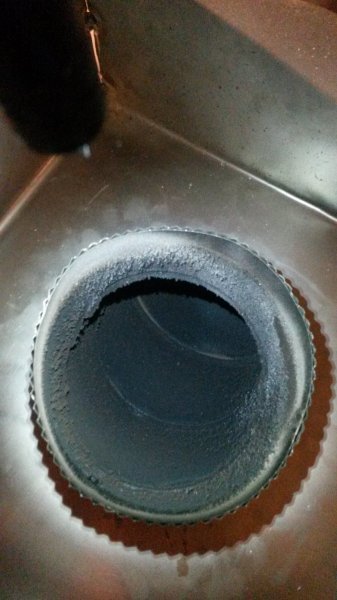

    I had some days with warm weather so I decided to clean the stove and pipe. The pipe, to my surprise , was very clean. The only hint of build up is just really fine soot that wipes right off. Even what I could see of the liner looked really clean.
    It's nice to know you can run seasoned wood at a smolder and not have creosote problems! What you see in the picture you could wipe off with your finger.

    My reconnaissance regarding how cutting the SS probe on the Condar cat thermometer affects the reading is preliminary. So far, it seems, cutting the SS does affect the read. I learned this from one of the employees at Condar; albeit not the guy who may know for certain. The guy who may know for certain is out for Thanksgiving. I will give them a call Monday. I hardly believe that a moderate burn in your stove is gonna create a cat temp that will cause damage. But your concern is more than valid.

    BrucePA-CWood , funny how our timing was so close on posting for the same issue. I just heard back from my guy, his title is Vice President and Marketing Director at Condar. I'll let you know his name in private if you want to know.
    This is his response to my e-mail question yesterday; "Hi Darrin, Not to worry, trimming the probe will not affect the thermometers performance or calibration".
    Maybe your contact knows something different? Maybe mine is throwing a smokeshow? I dunno...

    ....Not making me feel "warm-an'-fuzy' in the confidence department about Condar. But giving them the benefit-of-the-doubt; maybe the guy who is off for the holiday will know definitively. In the mean-time; I just can't believe your cat is burning that hot. I think Lorin sent you the extra-special stove that is super efficient! :)

    Well said and I'm sure you are right when we lean towards the Cat thermo as being a little off. If you see the numbers on the stovepipe and the surface temps right next to the cat, they all seem a little low for a cat therm that reads 1800*. I'd think if the cat was reading 1800* the surface temp should be a lot higher than 525*.

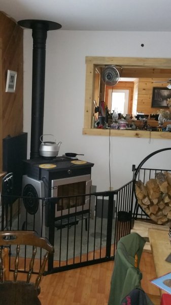

    these stove analytics are awesome. A buddy of mine has a smoke dragon that eats more wood than I do pizza. His stack temps were insane and his solution was to install a Magic Heat (yea, I know, I know). The Ideal absorbs the heat and radiates it out into the room. I installed a Drolet AC02055 thermodisc on the back of the Ideal which triggers an Air King fan that's mounted behind the stove. It moves a ton of hot air and is dang near silent, as opposed to the squirrel cage blower on my 2010 EPA tube stove that was louder than a fat drunk guy.

    Can you shoot some pics of your fan / thermodisc setup? Please

    I am running a small fan constantly, I like the sound of what your set up is. . 1417029774763.jpg
