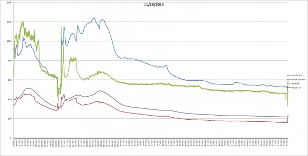

    This is what my IS looks like when burning overnight. You can see the big bump when I reloaded it in the evening and then it runs unattended until 7:00 AM (which is mis-labeled as 8:00 AM- just subtract one hour from the X- axis).
    What the graph shows is a reload followed by an 11 hour burn: note the firebox temp. jump way up and then the cat. jumps way up: that is the wood reload, then a short run with the bypass open, then the bypass closed followed by a closing of the draft to the third hash mark as I remember.

    I love this data. Do you have the stone side panels, and if so do you have a way to datalog those too?
