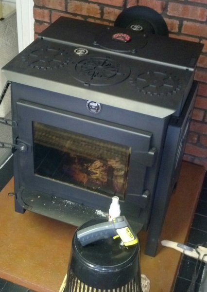

  19. Gark
    Gark
    1,312
    4,550
    SW Michigan
    We measure it many spots. Should we buy stock in thermometer companies? Really though, the black+red thermo on the covered top flue exit is where Woodstock suggests to read as "stove temp.".
  20. My IS heats my home
    My IS heats my home
    Dec 1, 2013
    7,394
    17,655
    Albany, NH
    I still don't know where the hottest spot on the stove is for "stove top temps"
