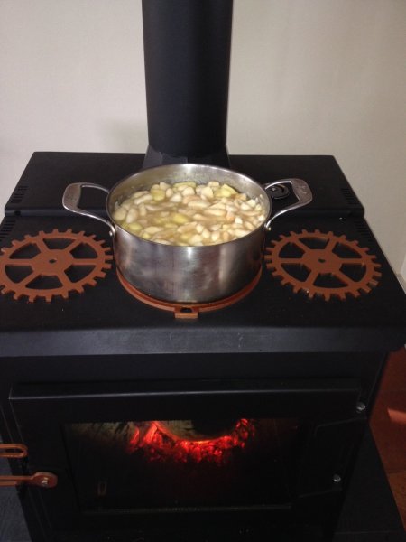

    It's applesauce season, and the IS is helping out.
    Just the third time I've run it. Loving the burners on top. Right now I have the applesauce finishing up, and turkey stock on one side burner, and carrots, celery and onions braising in a pot on the other side burner. Will eventually become winter squash soup, one of the kid's favorites.

    Burndatwood, pop that center burner cover and you will get more heat and less likley to scratch the art work that makes it yours.
