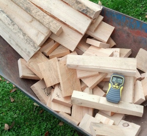

    The IS crate 2 X 4 wood base boards are 16% moisture content and the 1 X slats are 10% MC. IMG_20141024_105123_660-1.jpg

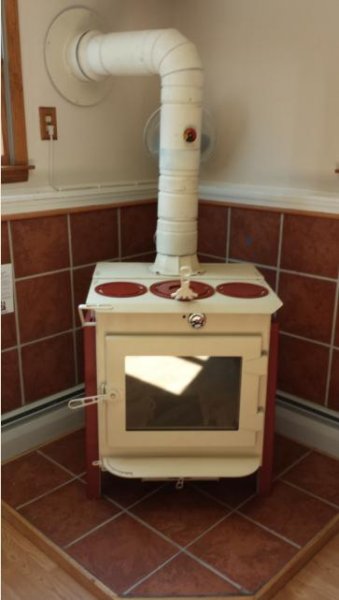

    rg woodstock ideal.jpg Well, I got everything done including mounting of a Drolet thermodisc for wall-mounted fan that is behind the stove. We had discussed cutting a hole in the heat shield and mounting a fan to that, but the design of the heat shield doesn't allow for try air circulation around the stove. The firebrick diagram in the owners manual certainly helped, and after a few minutes of trial and error, they started dropping in easy peasy. I have a lot of touchup to do on the stove as with the light color, all of my greasy fingerprints show up and they won't come off with typical household cleaners. Gonna fire this thing up in a little while, but am still very concerned about the ratting from inside the cat.

    Thanks for the welcome to FHC. And thanks to you and please allow me the opportunity to thank all of you out there in "FHC-land" (you know who you are)! I have been diligently reading all the entries regarding the IS/Progress Hybrid, Lopi Cape Cod and more over this past year. It is the information from all of you that enabled me to make the best wood burning stove purchase (for my purpose). Yes, there are some decent stoves out there, some good and some great - each for their own attributes. Through all your generous sharing of information, I now feel confident I have the best stove for my situation (although I must admit I still have a little stove-envy regarding the cast iron-enameled Cape Cod from Lopi and the Progress Hybrid from WS).
    Regarding your issue with the cat, I would communicate w/ Lauren et al from WS on the cat-rattle....
    Can't be a big deal. I'd venture that it isn't. But of course very fixable considering the customer service at WS.
    Your set-up looks great! Very impressive stove-to-room color coordination and that tiled-corner the stove is installed in will help radiate the heat from the stove out into your home.

    Hey golf- you got yourself a really good looking stove / hearth setup there!

    Thanks Gark.....my wife and I hemmed and hawed over stove colors for months....The burners and side shields are terra cotta stove paint that I picked up online. Truth be told, it's a little too red for my liking, but that is not a priority. So far, operating the stove is a bit of a mystery. Using a Condar double wall flue probe (visible in the picture), I got the flue temp up to 600 and then engaged the cat. There had been billowing smoke coming out the the chimney pipe before cat engagement, and now the smoke is gone. However, the fire completely died out, even with the air set to 40%. Never having had a cat stove before, much less a hybrid, I don't know if this is normal or not, and I'm totally paranoid given the pounding the stove took from the inept forklift driver.

    The clue showing that the combustor did its job is no smoke from the flue. The burn you describe is what I consider the Holy Grail of running a cat stove - no flame in the firebox (just maybe a soft red glow on a few edges of fuel), heat from the cat and no smoke. In my thinking, that process will yield the longest burn, IMHO.
    The secondary burn fireback (ceiling) in the IS seems to decide on its own whether or not to make those beautiful blue flames. I don't mind if the firebox temp is below the 1100f needed for blue secondaries, so long as 'no chimney smoke'. Like any stove, each burn will behave different - depending on some variables (many small splits vs. few big splits, woodspecies, wood moisture, load size, outdoor temperatures to name a few).
