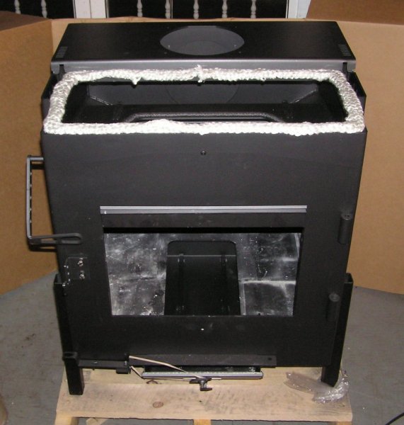

    The new IS is going in tomorrow, providing we can get the present stove out (not sure if enough people are going to show up for that one). A quick photo of an IS stripped about as bare as possible. The stove is fairly easy to move in this condition; just going by the weight of the stone, brick and the parts that were removed (and that is just a guess really), I would say there may be 300 lbs. of parts added to the bare carcars shown here. IS stripped.jpg

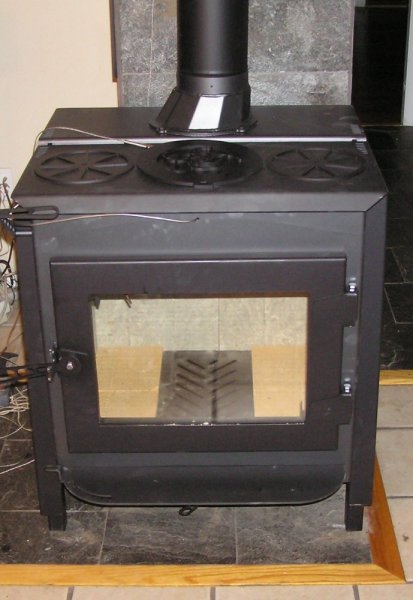

    Got the stove installed last night. With everything removed that can be removed, it was not that heavy and four of us actually carried it into the house without any dollies or other mechanical assistance.
    Reassembling the firebrick / stone / grate into the firebox is an experience that everyone should enjoy. Like some diabolical kid's game that cannot be solved, it keeps the user entertained for hours :) Really, it took about 2 hours to reassemble the internals (Easy Boys!) but it is tricky.
    My hearth ends with the edge of the hall and is offset into the room from the chimney. So the stove ended up to the left a bit too far. I did not think of it but a friend helping me install and assemble the stove tried the smokepipe adapter 90 degrees out and lo and behold, it <almost> aligns the smoke pipe with the thimble! The pipe is still just a tad off vertical but in person it does not look bad at all.
    Ignore the wires hanging off the stove, those are thermocouples that will be replaced by much more appropriate types now that I have the stove and can get the correct size and type thermocouples.
    By the way, I have not heard anyone mention it yet but my stove came through with an Outside Air Kit attached; I ordered it that way but there was not an OAK available. I guess there is now.... Nice design that seems to fit and work very well- I can snap a photo of it if anyone is interested.

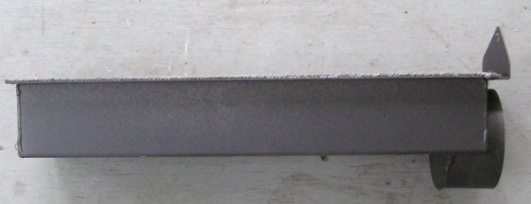

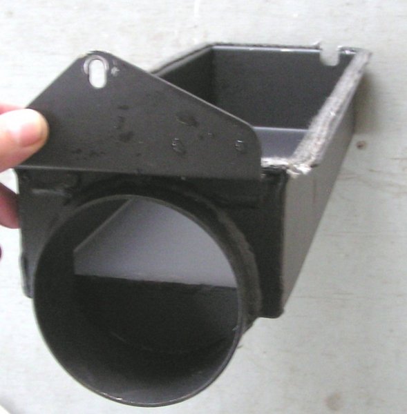

    The OAK mounts on the bottom of the stove, on the left hand side (facing the door of the stove- same side as the door latch) and runs front- to- back. It slips into place with a bit of gentle tapping and is held in place by the same bolt that covers the slot in the back of the stove where the draft slides are installed. It is really a nicely executed, well designed device IMO. A few photos:
