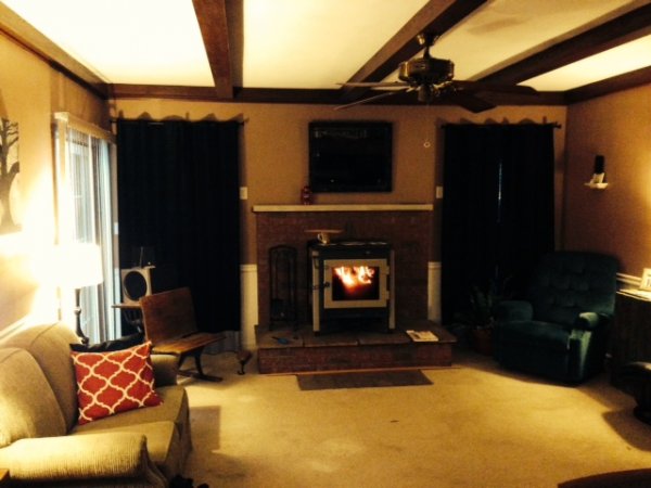

    I have only run my IS two times so far since installing it, both for break-in fires to cure the paint. While doing this I had some time to look at what this stove can do. Despite only burning at lower temps it's incredible how reactive this stoves controls are. From a flue temp of 250 and then moving the bypass to engage the cat the flue temps immediately came down 20 degrees in the first 3-4 minutes and the air control damper was also found to be very detailed in it's control. Something as simple as closing the damper 1/5 can take the flames away and how quick even that happens.
    It should be a good season to test and see what this stove can really do. Looking forward to your input along with the many other new IS owners we have on the forum.

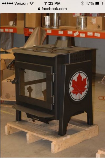

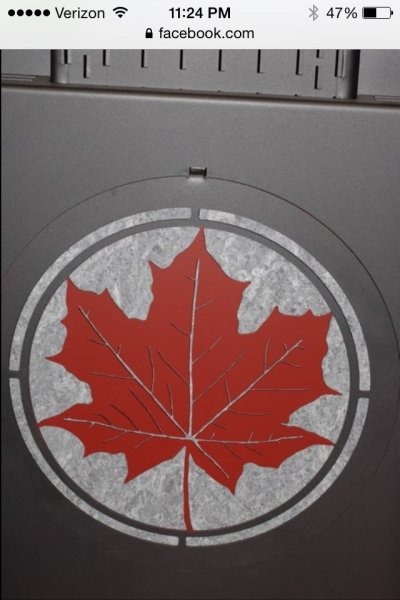

    thanks Brian. I actually tagged myself when the stove came out. Lorins camera takes much better pictures than mine.

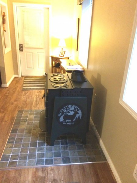

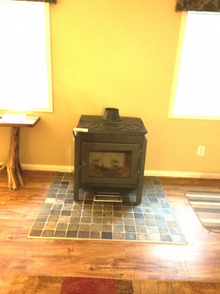

    I got the stove in this weekend and will try to have it hooked up late this week or early next week. :thumbs:
    Work is interfering with the install.... I have a pretty big job with the chimney ahead of me.
    Thanks to those sharing their results, it is fun to learn about how the stove is working out for you guys. :)

    Stove looks great fanatical! Did you got to WS to get it or was it shipped?
    What are your plans for the rest of the install?
    Is there a heat shield with your IS?
