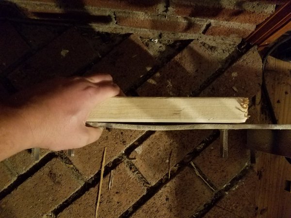

    I also took out the cat. Gave it a good vacuum, flipped it, and put it back in. I noticed my radiator was slightly warped last time I cleaned it, so I took a quick picture of that too. Using a 2 by 4 for a straight edge so you can see the severity of the warping
    Should I call Woodstock?
