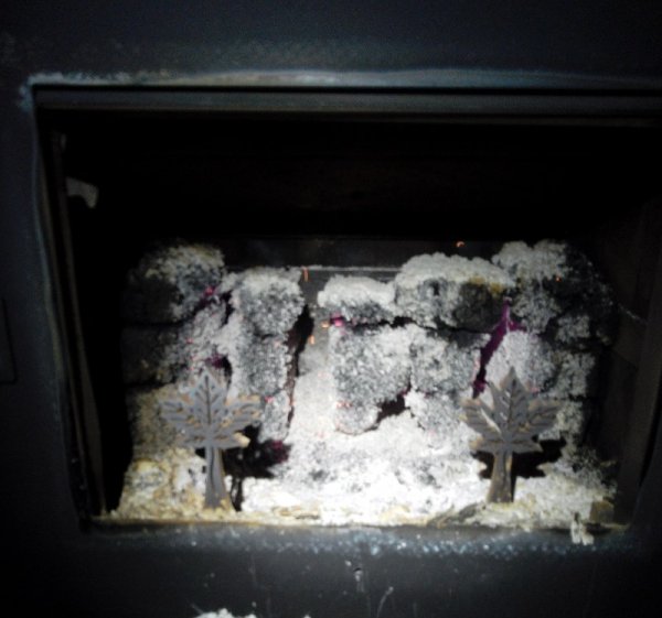

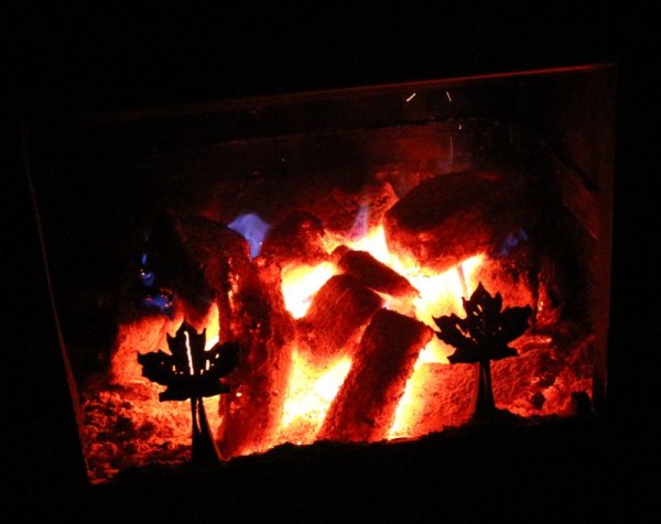

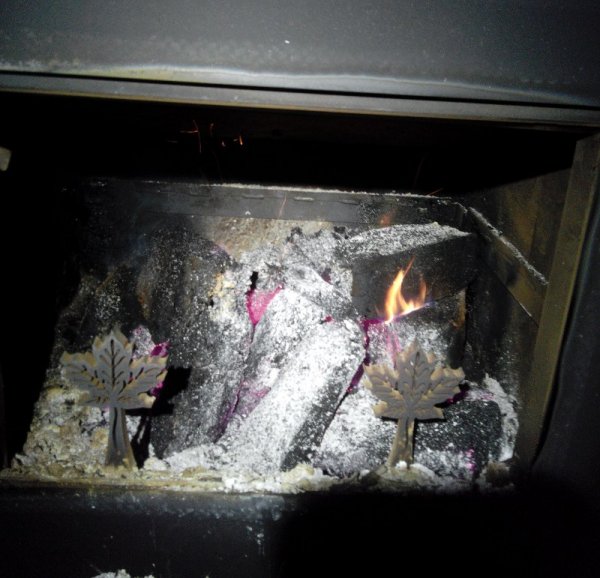

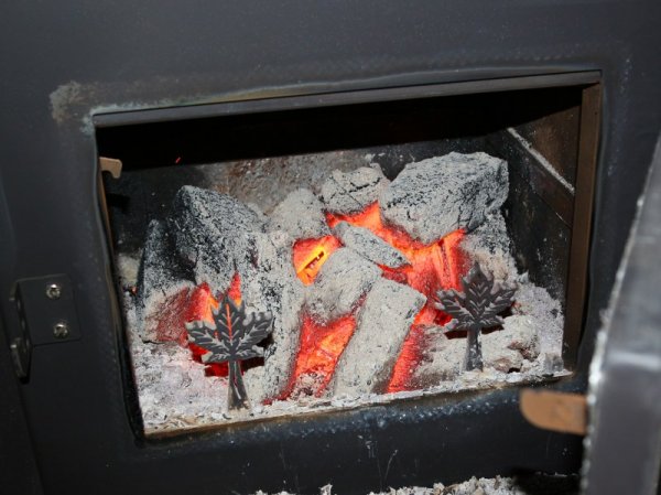

    Well my long burn went well. Like always with a really long unnatended burn I was left with a stove that had cooled down with fuel still in it. Need to try the ash pan mod one of these days, but it was no big deal. House was warm, I stirred it up and got it back going again and burned for another couple hours before reloading, total burn time around 26 1/2 hrs. When I first got home the cat probe was at a smidgen under 300 and the Woodstock magnet mount on the stove top about 220F. Here is what it looked like...
    The pile in the back of the ecobricks was about the same height as they were after loading, but much of thier mass was gone. I knocked the pile down and stirred it a bit...
    Hard to tell in the pic but some of the bricks along the outside edge still had completely unburnt parts that were still tan colored, you can see a bit of that to the right of the flame above. After I stocked it a bit I had active flames and a bright glow and the stove actually warmed up a bit. In about 30 minutes had 600 on the cat and 375 on the stove top. I bet I could have got 2-4 more hours out of those easy, but it was almost midnight I had to go to bed so reloaded.
    Same shot with (below) and without flash (above) at about 25.5 hrs.
    You can see the mass of the coals better with the flash, but it wipes out all the little blue flames (there were more than the pic even showed anyhow) and the intense glow.
