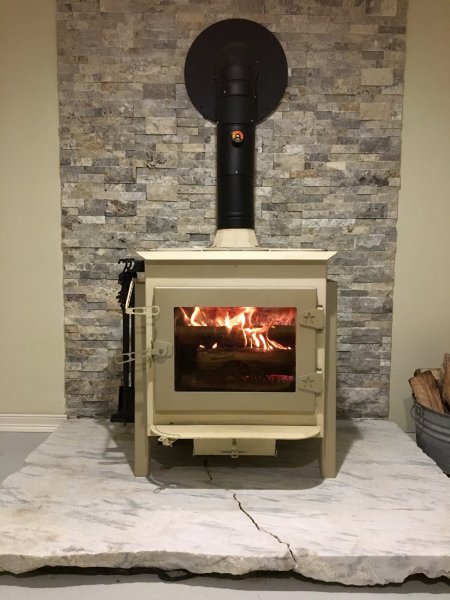

    image.jpeg image.jpeg Here are some pics of my new setup. This is the third stove setup I've done for my own IS and hopefully the last for some time. I didn't run it at all last year and, even with a new chimney, it's remarkably similer and it came back to me rather quick. The entire setup is built with a lot of stone and steel studs. My insurance co. better be thrilled. I Lao put in an outside air kit and Indinfeel so far it was worthwhile. I don't see any change when I run a portable fan nearby, or the bathroom vent. I think my stack probe somehow screwed the pooch sitting in storage so I need to order a new one.

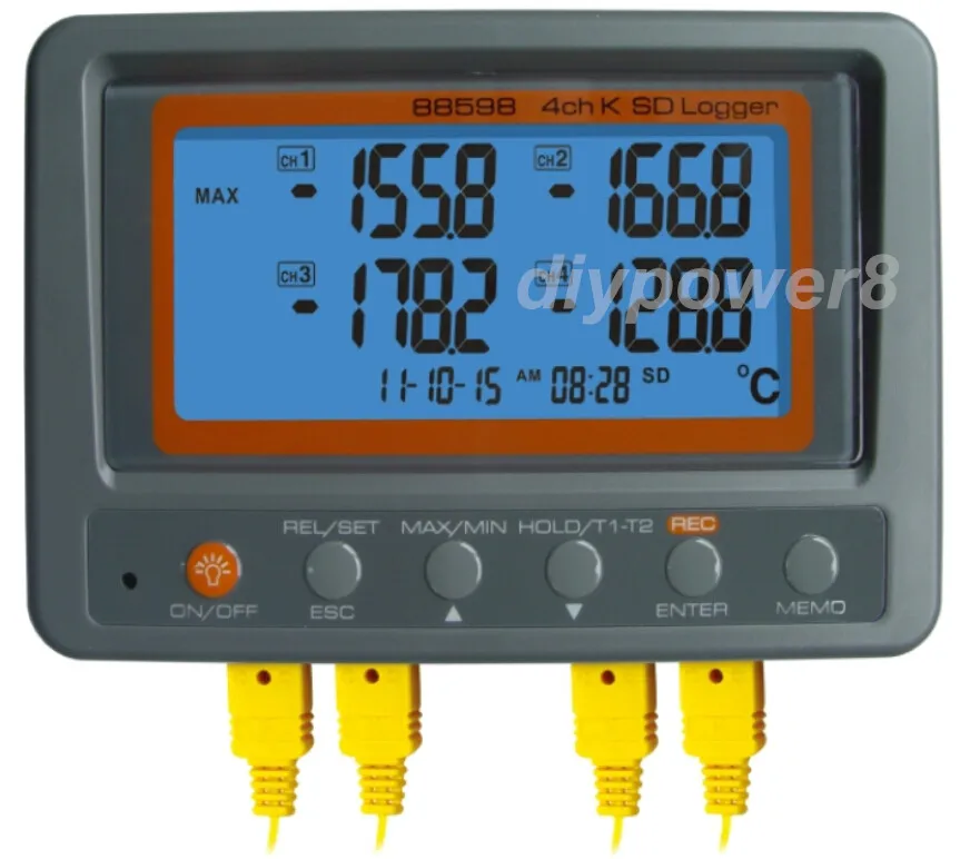

    I know a couple of you are running this logger:
    If you are, I'd like you to do a little test for me. Once the stove is hot and all 4 channels are up in the high hundreds of degrees or higher, unplug each thermocouple from the logger one at a time and watch to see if any of the other 3 channels jump significantly in reading. In other words, pull out channel 1 and see if channels 2,3,4 change. Then plug channel 1 back in and pull out channel 2 while watching to see if channels 1,3,4 change, etc.
    As you saw from the picture, I added a firebox probe last night and tonight I burned with it in for the first time. I got some really weird readings on my stove top temp channel. Unplugging the FB channel instantly made the STT snap 100F lower and read correctly. Plug the FB channel back in and the STT is instantly 100F off. Same problem doing it the other way around: the FB channel reads 100F differently depending on whether the STT channel is plugged in or not. The really weird thing is that it doesn't affect the other two channels on the gray ChiCom logger nor does it affect either of the Auber displays. Even weirder, if I plug the two problem sensors into my Fluke 52 II thermometer, they both read perfectly fine at the same time. It's ONLY when they're both plugged in to the gray ChiCom logger that they have problems. I've talked to my electrical engineer friend about it and he's suggesting it's either a defect inside the gray ChiCom logger or a bad circuit design that's susceptible to small ground offsets between the TC probes.
    If you guys can do the test and observe similar results, it's a bad circuit design. If you guys don't observe any change in any readings as you plug and unplug one sensor at a time, then it's probably a defective logger and I have to go through the hell of trying to return something to China.
    Thanks!

    Ah, the genuine 'China' brand of thermocouple reader / recorder. Just like, say a Red Lion or Omega but 1) far cheaper and 2) far, far more cheaply made. :) They do work, kinda', mostly but as you have noticed, have some quirks. One of them is that the channels are not fully isolated from each other and apparently not from the internal ground either. Another is that they seem sensitive to SD cards, at least the ones I have are.
    I have one I used to set up a new boiler and now and then, it would occasionally show an error on one channel and more rarely, all channels. Powering the unit down and back up solved the issue but I often had to do it several times. Finally, I spent some time troubleshooting it and found that if the actual thermocouple bead was in contact with any metal part of the boiler, pipes or fittings, all of which are of course hard- grounded, the unit was unstable. Simply electrically insulating all thermcouples of the bead type cured the issue for me. Of course other than reading the actual flue temperature, all other channels were low temp. and so a simple piece of tape under the thermocouple was sufficient; that method will of course not work on any part of a woodstove. Perhaps sheathed thermocouples for all four channels might cure that flaw? No doubt it is the device at fault but at the selling price, there is simply nothing else on the market that will do the same job, at least nothing that I am aware of.
