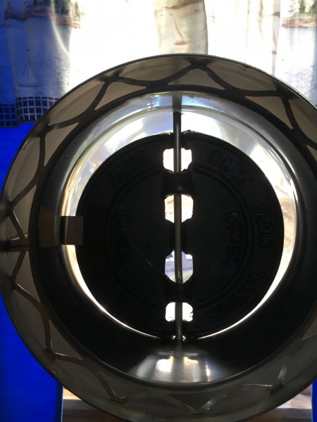

    image.jpeg Installed my damper today. I had heard there was room for air to flow around & through the cast iron damper plate, but did not realize how big of gaps they actually are!
    That being said, I have a full load in, damper at a 45 degree angle, & the stove is cruising nicely. I have never been able to load it over half full without it whistling or running away on me.
    Brad38, Mitch Newton and papadave like this.

    yup pa.forester you got good draft.. I told Tom (Woodstock owner) what my draft measured he said yup put in a damper!

    Yes, even "closed" all the way, they really are not even close to closed. I usually run my I.S. with the damper horizontal or fully 'closed' and I still need to throttle the draft (the factory draft) to control the stove.
    By the way, with the damper closed and the draft set a bit further open, my stove actually generates more heat in the house and less heat up the stovepipe.

    I was actually just thinking my stove should generate more heat. I did have to run my damper horizontal/fully closed once the stove got up to temp. It's much more controllable now!

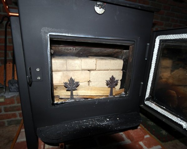

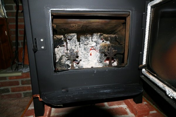

  19. T-Stew
    T-Stew
    Mar 11, 2015
    455
    1,016
    I don't think just 4 Enviro bricks plus kindling (assuming this was a cold start without a thick bed of hot coals then?) is enough to sustain the stove properly. Even on a hot reload with a lot of coals 4 Enviro bricks isn't much. This is a very large heater and to maintain proper combustion it needs a certain amount of heat 500+ for cat, 1,000+ for secondaries to burn properly. The stove itself is going to suck up a lot of heat especially on a cold start, as the firebrick/soapstone.steel sucks up that heat and while your sensors may indicate it's hot enough it might just be the active primary flames and once you start to dial it back to normal operation the temp drops and can't sustain proper burn. The secondary air gets preheated by channeling through the hot stove, so just having a tiny fire isn't going to keep things hot and the air preheated. If you're just planning a short burn (not continuous 24x7) and don't want to overheat the place you could either just let it rip with a mostly primary fire, heat the stove up good and hot and let it burn out early, hoping the thermal mass will stay warm enough to heat the place long enough. Or I'd load it more normal and just idle it lower. I've found to really burn well it needs to be over half full or the characteristics drastically change. But you can certainly load it mostly full and turn it down into a cat only burn and not generate nearly as much heat. Cat only burn still throws off a lot of heat when the cat is well over 1000F, but If you can keep the cat say under 800F and stovetop around or under 300F it's a very gently heat. If that still overheats your house than crack a window open, fresh air on mild days is always nice anyhow.
    It also seems to take a while to get Enviro's to really outgass. Always seems to be a big spike several hours into the burn, unless it was just from the falling outside temps or wind picking up. If I am going to load mainly bricks, I'll throw a couple splits of hardwood in there too to make sure I got a good burn for 2-3 hours when the bricks sort of take over. I experimented with many different ways last year, didn't find a huge difference how I exactly placed the combo, but found 1 layer of even splits on the bottom with a layer of bricks atop them to be good for lighter loads. The splits will burn a little quicker and keep a good hot coal bed under the bricks. Tightly packed bricks keeps them from taking off to quickly at first, and after several hours when the splits disintegrate underneath it shifts the bricks around which keeps them burning better later in the burn. The bricks do tend to slack off a lot more later in the burn, so stirring them up 2/3rd the way through the burn helps, and cordwood turning to coals underneath helps do this for you.
    For a shorter burn not to overheat the house though I'm doing about the opposite of you... instead of using an extremely dense and high btu fuel I've got a cord of spruce for the shoulder season. You can pack the firebox full and have only about half the btu of coordwood, and a fraction of eco bricks. And easy to maintain and control the burn. Just some food for thought for next year. Often time people are giving away softwood for free since nobody around here thinks its good for anything except plugging up your chimney and housefires. :picard: But if you've got the Enviro bricks to burn, just try packing more in there and getting a nice burn, and just dialing it back. During the shoulder season is the time to not mess with the stove so much and enjoy a just-warm-enough stove that can burn 24 hours or even 48...:yes: Why mess with a cold start, kindling, matches, and struggling stove once or twice a day when you can reload once and cruise for 2 days with very mild heat :)
    Of course experiment with lighter loads before you go all the way!!! But fwiw here is 24 Enviro bricks (formerly called eco bricks) in the ISH:
    I did several smaller burns prior to loading up this much, experimented with 12, 14, 16 etc.
    At 31 hours elapsed:
    And 48 hours and still nice and warm and glowing after some stoking up:
    Stove top temp averaged around 275F, not going to overheat most houses with that. Spent about 4-5 hours out of the 48 between 300-350 is all. Should be great for shoulder season, as long as the draft isn't wonky with outside temps (that burn I photographed above was during somewhat mild Feb last year, but still much colder than now - I have a second stove too so can get by more with the Ideal Steel just cruising low and slow).
    Of course YMMV, draft and control characteristics may be different for different installations, and be careful loading that much btu into the stove at once until you have a good feeling for it.
    pappy88 and papadave like this.
