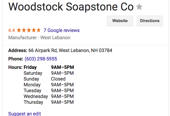

    I'm ready to cut to the chase scene already! They are open Saturday. Hint hint. ;)
