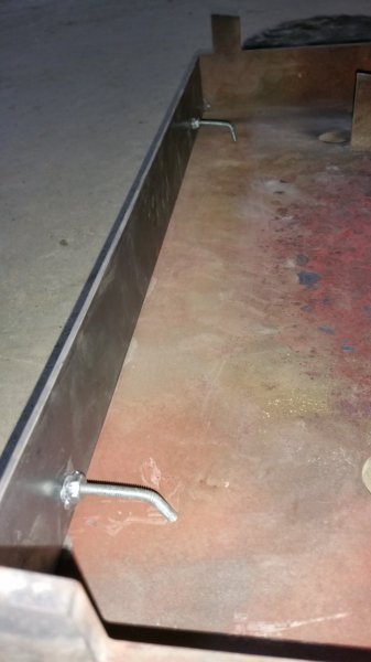

    exactly how did you fasten the "mod" to the radiator?
    Does it close off the rear exit of the radiator - down to the sled?

    It does not close off completely. I used a 2 in piece flat stock cut and trimmed to fit. Added two small 90° brackets to the falt stock then drilled two holes for 1/4 in threaded rod. Used two nuts on either side of the mod plate and left an extra 4in (I think) of extra and bent them up to pin it to the radiator. I have pics somwhere, if I can't find them I will take more tomorrow.

    Somthing just like this.

    I know you are talking to Erick but just to stick my two cents in.... I did not completely cover the rear exit (Easy Boys!) of the radiator, I blocked off the two inches. As to fastening it, I used two pieces of 3/32" SS wire, TIG filler rod actually. I believe Erick made a couple of threaded rod devices- his is the better way but mine seems to work well enough.

    And with respect to yours and ericks mod on the radiator. Did either of you consider actually welding the rear piece of steel? My thoughts are if the radiators are warping from most IS owners reports would a fixed (welded) piece of flatstock help support the vulnerable section of the radiator?
    I put the replacement radiator I got at WS Saturday in on Monday. I may take the old radiator to my welder and have him tack on a piece like in Hollywoods pictures.

    Tacking the piece on the back of the radiator will not likely prevent warpage on the front edge. You would need something closer to the problem area.

    "Copy-that" regarding the front of the radiator plate as area of potential warpage...actually saw that in the first in the series of pics of the radiator above (nice clear pics and cleaver fastening job). Clearly the FRONT edge of the radiator is taking the "heat" (pun intended). And with Brian's "block-mod" (culdesac-mod?) - the front edge of radiator plate should actually take even MORE heat. So....wouldn't be a bad idea to tack on the block-mod AND preemptively tack on a piece of angle or square stock as a stiffener up front (taking into account travel of the sled and top of stove closure). Tack stiffener onto top versus bottom of radiator plate - thoughts please....:sherlock:
    Another thought: Regardless of top or bottom - maybe attach stiffener to front of radiator with stainless or galvi. stove bolts to reduce risk of cracked weld considering the expansion factor at that area of the radiator. That front edge of the radiator takes the "lions"-share of the abuse from the "cat "(there's a metaphor in there somewhere...:smoke:

    Atop the radiator would likely be best, so to not actually restrict the air flow and just redirect it with the mod on the back of the radiator. Clearance is going to be the issue. If you were to take a piece of what ever size brace material you wanted to try and just lay it in on top of the radiator and operate the sled to make sure it doesn't contact anything. I don't think It needs to be a big piece of material, maybe 1/4 flat stock on edge or even metal rod might do the trick. At that point it's all about clearance.

    Oops. Considering Hollywood's earlier pics of the "new" radiator plate with the stainless shield mod from WS, any stiffener on the front edge of the radiator would have to be attached to the topside of the radiator as to not interfere with the stainless shield.

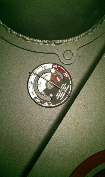

    I hear you. Interesting thing, my beta stove took waaayyyy more abuse for the time I had it. I buried the magnetic thermometers at least a dozen times. One of them was next to the cat port and the other just to the side of the top flue plate. I saw zero flaking or warpage on that one. I did ask if the changed the material and from the beta to production and was told they did not. 1886788163.jpg this was an hour after they left the house from dropping off the beta to me. The first break in fire. The last thing they said was "try and break it" and I did try.

    My magnetic thermometer is located just to the right of the cat probe port on the front of the IS above the door. And on larger or even moderate loads (without trying to run a hot fire) I see temps between 750 - 900 as a daily occurrence. I find it difficult to believe WS would make a stove that wouldn't handle this type of fire. Although, sheet steel deteriorates quite easily at the temps we run in the stove. Happily, the only broad peice of sheet steel (excluding structural steel channel) part of the IS in direct contact with fire is the top of the fire box. And the radiator that gets the brunt of the heat from the cat.

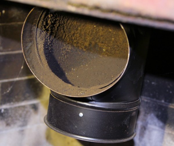

    I mentioned earlier this week I cleaned the flue for the first time and got a bit more creosote than accustomed too but I don't think too much, especially with the teething issues learning to run the new stove, plus some loose pipe joints I neglected to fix until now that I am sure where leaking some room air into the flue (the inner pipe was like slightly warped inward so from the outside I could actually see into the inside of the flue pipes).
    That is one year of accumulation from about 22' of pipe.You can see about how much the buildup is since the tee itself hadn't been cleaned (I mean the stuff clinging to the walls) it's not very thick, but perhaps a hair over 1/8" in thicker spots. I didn't fill up any measuring devices since I vacuumed it, but after leveling off and applying the formula of area of a cylinder I come up with .54 gallon or 8.5 cups. It really didn't seem quite that much, so my rough measurement might have been a hair off, but pretty close.
