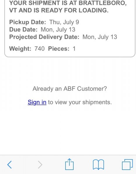

    Hi Steph,
    I had them deliver it to my dad's work. They have a loading dock there, and he happens to be the shipping manager. He'll use one of his fork trucks and load it on his truck and bring it home to me. I know, my life is so hard! Lol. (Btw, I just tracked it, and it's already in PA. They aren't messing around!)

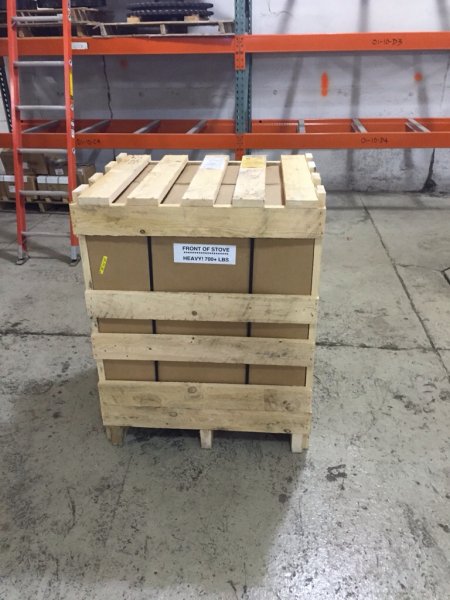

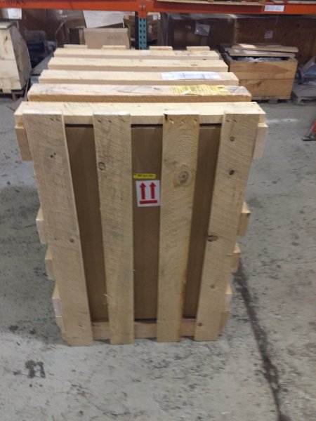

    Dad sent me these from his work. Looks like it was delivered in good shape! :ups:

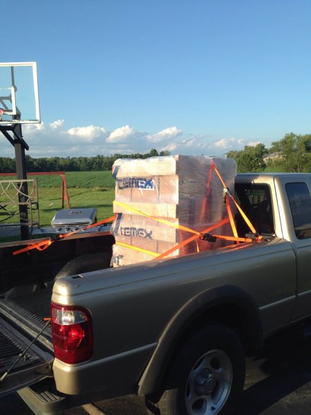

    Well, made it home! Ran into a storm, but the shrink wrap held up good. Will have to wait to unload, my grandmother had a bad spell at the nursing home. Headed over there.
