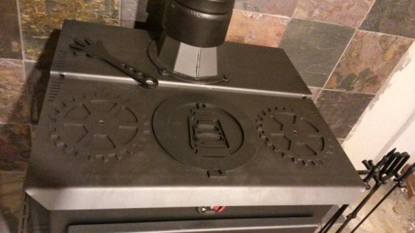

    OK papa Dave, here you go. .. thanks for being patient. Does anybody know how I can rotate the photos? 20140906_205538_Richtone(HDR).jpg 20140906_210106_Richtone(HDR).jpg 20140906_210154_Richtone(HDR).jpg 20140906_210344_Richtone(HDR).jpg

    Galaxy S4 active. They were taken with the phone held upright. My gallery shows them upright.

    This stove had no problems getting started!

    I am thoroughly impressed. I'm seeing about 450 degrees in front of the cat, a dark box, and no visible smoke coming out of the chimney. I don't think I will be missing the Quadra-fire this winter :drool:.
    The heat output on the top and front is very impressive. The soapstone sides are barely touchable.
