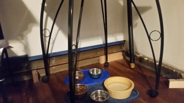

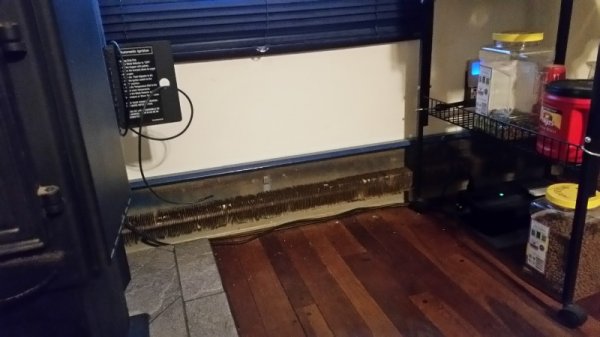

    The sheet rock that I had removed was 1/4". I had 1/2" installed. That caused a problem with fitment - heck, just trying to get the backplates, uh, in back, was a major deal, but I finally got it done. However, the supports no longer had room to get hooked up to the backplates (I had a heck of a time getting them out of the original configuration in the first place). So, I couldn't hang the front faces or install dust covers. For years I have ignored the fact that I just have copper pipes and fins running along the base of most of the exterior walls that look like cr*p.

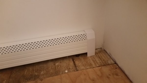

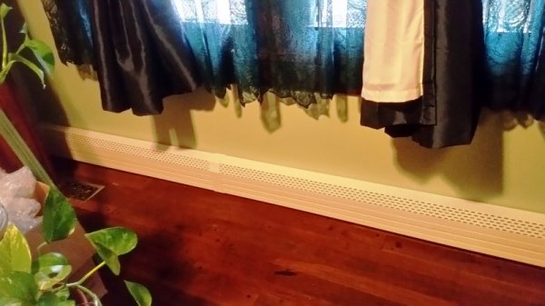

    I bought one 4' section, and the matching left/right side legs to try out in the bathroom and the assembly slipped over the backplate like a charm (picture from 3/2/19)

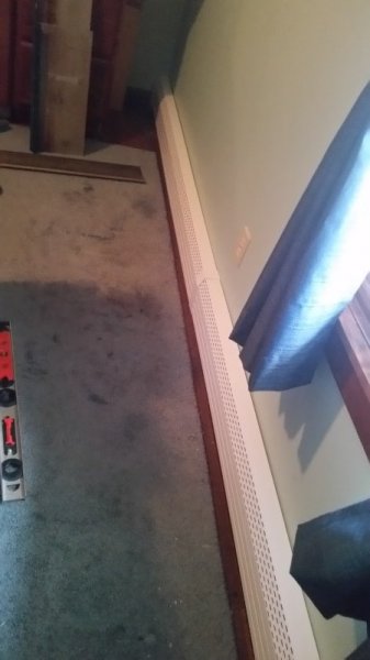

    Cutting the backplates was not an option as they are made from a thick metal that tin snips barely dent. Plus, trhying to cut 8' of backplate would be difficult at best, so I was stymied for a bit as I looked around for an answer. For the shorter rooms, the office and bedroom, I was able to come up with using corner brackets to hold the covers in place. This was not satisfying as there was no backplate at all. Plus, trying to align them so that the 4' & 6' sections matched height was difficult. But still, it works as long as they aren't bumped (pictures taken 3/31/19)

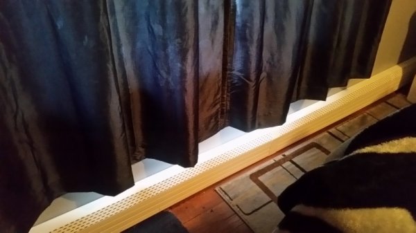

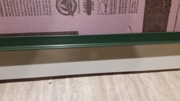

    The longer bedroom heater had to wait until I found another answer. Cleaning out the garage yesterday helped. Actually, I was just moving the rest of the pellets into the basement and had to move a box I have moved many times when adding/subtracting pellets from the garage. The box is 10' long and contains a couple of pieces left over from when I had the roof done. This time, I figured I would just take the metal to the dump so I opened the box, took a look and said, "self, hmm, this looks like it could work." There were several short sections of drip edge sitting there, plus one that is about 6' long. I took a short section, fitted it up, and sure enough my hoarding had once again provided a solution :)
    Although not quite tall enough, the drip edge still provides a nice backplate that can be screwed to the wall. It even has a little shelf that my level can just perch on, but it is still small enough to fit under the cover. The back lip of the slip on cover slides just behind the top edge for a nice snug fit and there are no worries about bumping it. So, as of today the craft room is sporting its new heater cover.
