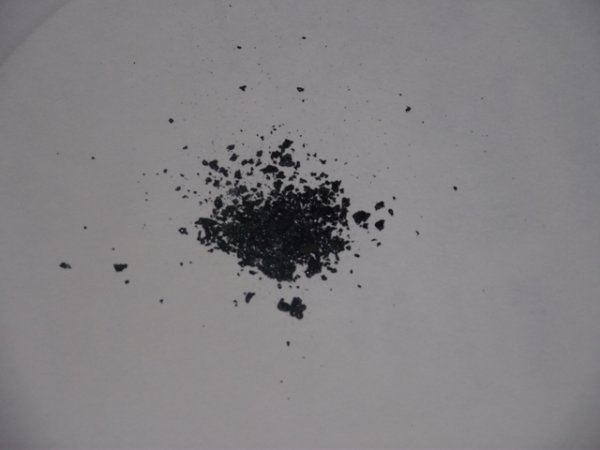

    So I ran the Soot Eater up the chimney today and gave the unit the once over. Vacuumed out the fans and vent, gave the glass a good cleaning. Got about 16 oz of brown fines. Used to get black crunchies but much better since adding a block plate and insulating.
    First pic is from today second is what I used to get.

    I think, based on your description, the pics are backazzwards.

    No not backwards. The first pic is fine brown fluffy from today. The second is just a small amount of the black shiny crunchy stuff I was getting in the past but there was plenty more of it! Had worse actually. Never any glaze-sote but not great. Thought I had a pic of an entire cleanings worth of the crunchy crap but can't find it :emb:.

    Ah, ok. Brown fluffy is gooder than black crunchy. You betcha.
    I used to get quite a bit of the BC stuff, now not so much.

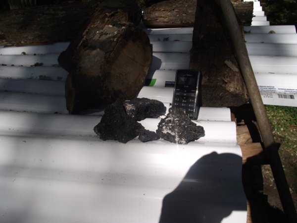

    How 'bout these chunks of nastiness from a few years back! What a newb!

    Last 3-4 feet of my block/flue tile lined chimney got a little of this last season, when temps hovered at or below 0 for a few days.... Our stove is inefficient, and since my wife and I are gone at least 9 hrs(same part of the day), we have restarts often, almost every evening.... Spring and summer rains plus summer sun break it all up and terra cotta is clean by September....
    Be nice to be able to afford cat stove and SS liner.... Ah, one day.
    I like the lack of output from your stove, J:yes:
