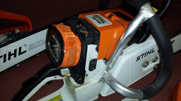

    Outerwears makes a nice pre filter for the HD filter setup on the 441,440,460, etc.
    They are pretty cheap and come in almost any color you want :)
    If your gonna do some extensive milling? I'd look into one. For about $10, they are worth it.
