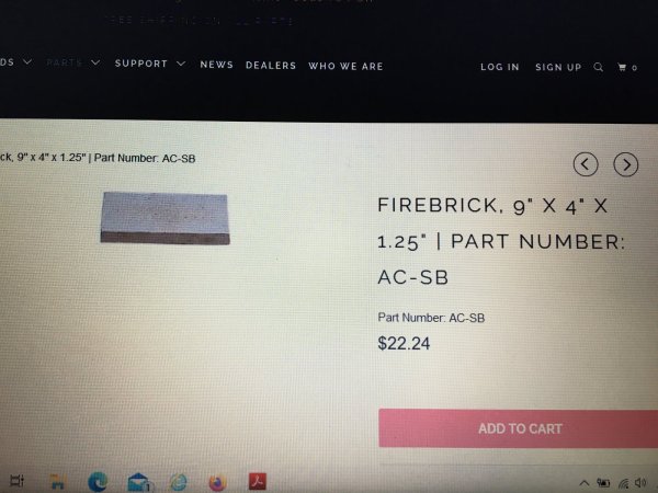

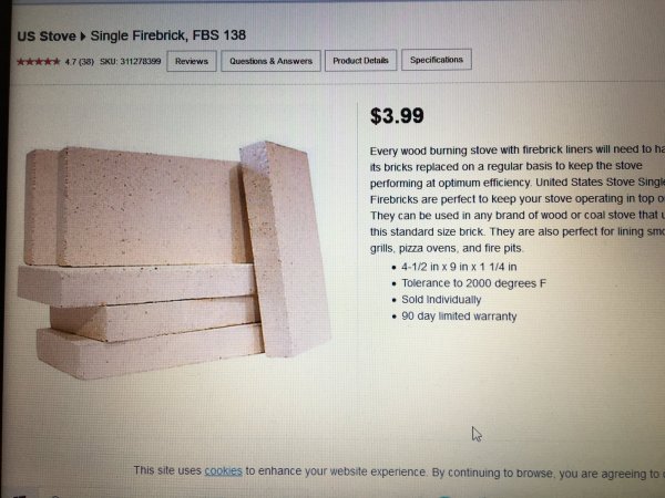

    Getting ready to head out to slay an elephant trunk this AM, then head to TSC for firebrick. WOW! England’s is proud of theirs!
    That’s per brick!

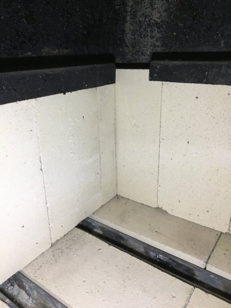

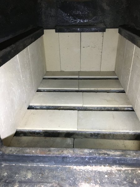

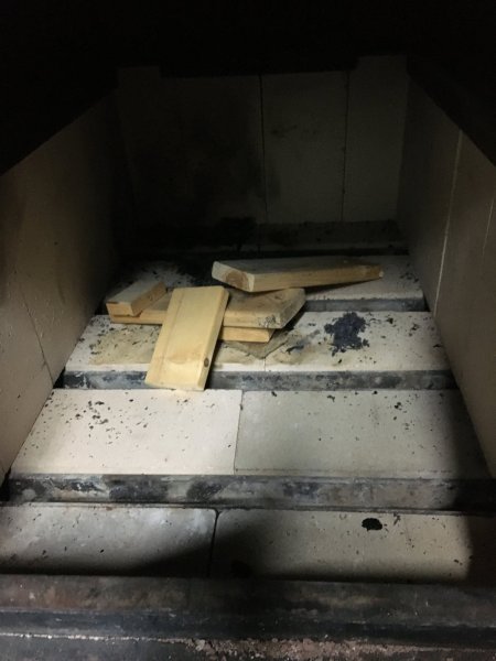

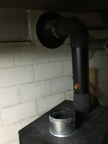

    Made some progress yesterday. Got the flue pipe installed and all the firebrick cut/installed.
    All the floor brick needed cut to 4” and one shortened.
    This pic shows the skinny brick due to TSC ones being 1/2” bigger than oem. I’m happy with it as long as those don’t break frequently.

  5. brenndatomu
    25,205
    163,964
    Huh...I was sure they used standard bricks...oops :emb:
    At least that diamond blade worked good, huh?! :D
    mat60, Horkn and The Wood Wolverine like this.

    Is your 90 double wall?
    Tough going without door pins!
    mat60 and The Wood Wolverine like this.
  8. The Wood Wolverine
    18,897
    121,841
    Yes, that 90 is double.

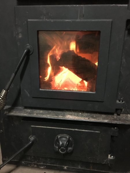

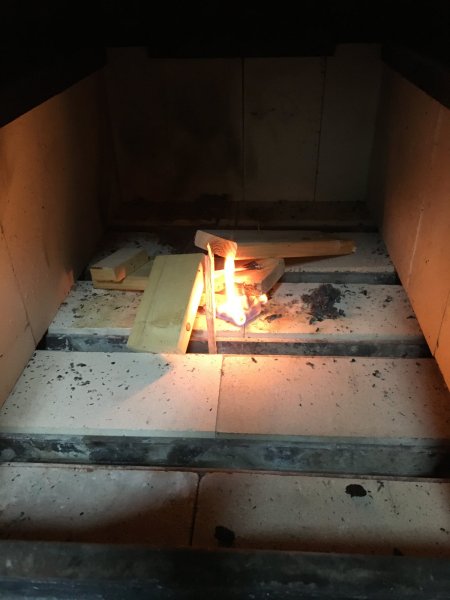

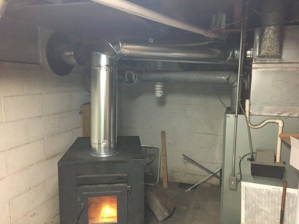

    Well, my new door pins came in the mail today. So I finished off the plumbing and fired one off!
    mat60, Maina, Marvin and 3 others like this.
  10. The Wood Wolverine
    18,897
    121,841
    She’s chugging along quite nicely.
    One question I do have, is left closed on the top draft?

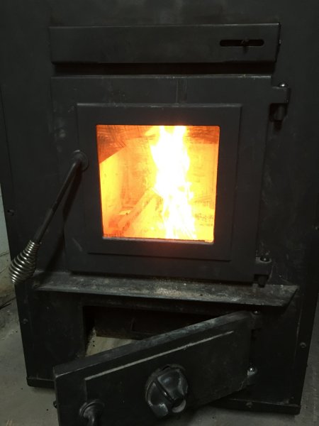

  19. The Wood Wolverine
    18,897
    121,841

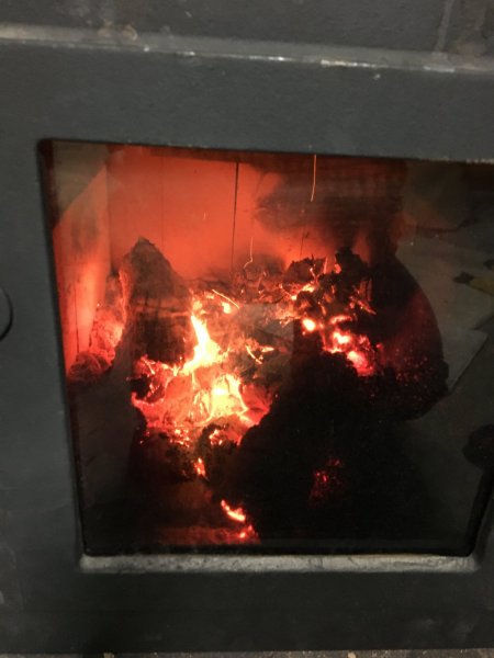

    So I’m thoroughly impressed so far. Came home 10+ hours later to this:
    I did crack the bottom door to stoke it a little bit. And the temp in the house.. 78!! Jeebus, if that doesn’t shed some clothing I don’t know what will. :rofl: :lol:
    Horkn, farmer steve, Maina and 4 others like this.
