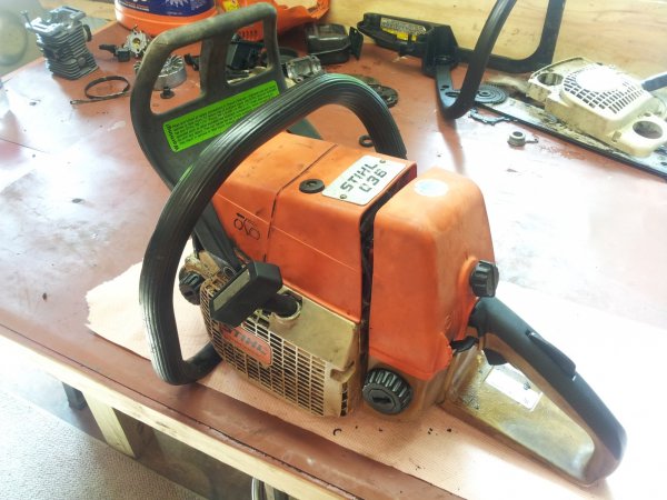

    20141109_142316.jpg Just finished this ported 036 for my buddy Ron660. Meteor piston , stock oem cylinder, 185psi compression, and squish set @.019. Lots of torque in this one 20140706_100517.jpg

    Looks like a good rebuild! !
    Chvymn99, bigbarf48 and Kg461 like this.
  6. cnice_37
    cnice_37
    3,211
    14,236
    Man that thing is cherry, new plastics all around?
  7. Kg461
    Kg461
    Aug 2, 2014
    652
    1,023
    Provencal, La.
    Ya. Painted crankcase, new seals, painted muffler and buffed cover with a muffler mod, new starter coil and rope/handle, new tank vent, new carb, new mastercontrol and spring, new ignition coil, new clutch system and oil lines, new clutch cover, new b/c, new air filter , new plastic. Meteor piston with caber f cast rings, original oem cylinder and I ported it, squish cut in cylinder and cut base to accomodate a base gasket left in and set at .019. Adjusted compression between 185 and 220 with gasket. Busted my dang thumbnail trying to start it at 220psi!!! Lol

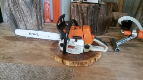

  20. Kg461
    Kg461
    Aug 2, 2014
    652
    1,023
    Provencal, La.
    I love saws and this is the reward to sit in front of with the wife and kids 20141110_072446.jpg
