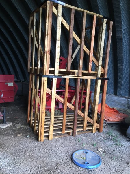

    Yes I posted them on here they are 4'x6'x5'high and when double stacked look real nice am considering trying to go 3 high but not sure if I dare or not.I keep them all in a shed and might actually get around to emptying one this year if I go through the first part of the pile(see pic) so I can save the hardwood.The ones in the pictures which are full have spruce in them.

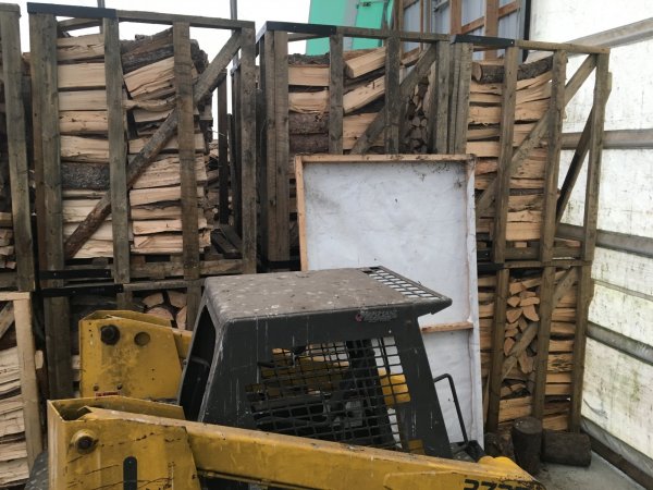

    Here's mine
    [​IMG] Hold ~1/3 of a cord each.

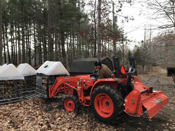

    That holds about as much as mine but mine is in double rows. Yours will get more air circulating!
    I started building some out of PT wood but the costs were too high for me to justify with the number of pallets I have
    If I tried to move yours with my forks, I know I'd knock it over almost every time
    Are you using strapping on top or poly twine?

    Metal plumbers tape.
    I built them one row wide because my lil forklift is only good for 1000#, and the forks are only 24" long.
    More pics here. I no longer take the wood right into the furnace room like I used to during when I posted this thread, too many bugs.

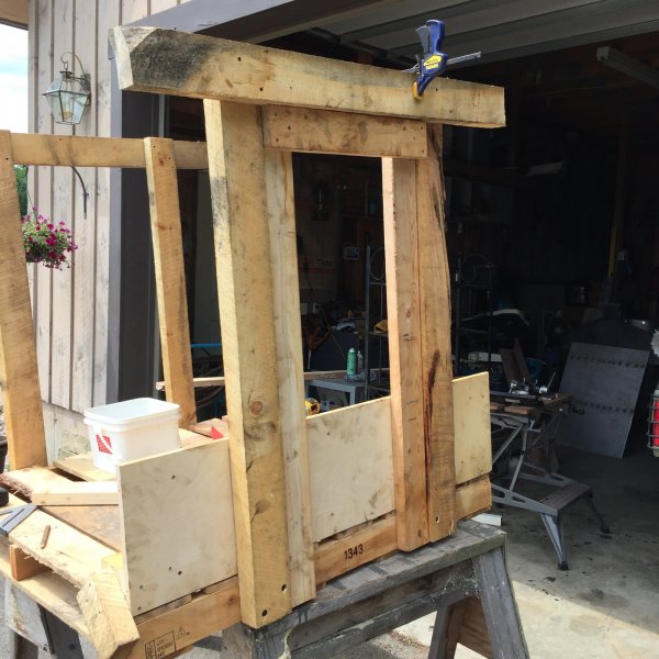

    So this is my set-up. I use a 48" x 48" pallet for the base and I add 48" tall up rights that I made an assembly jig to center onto the pallets.

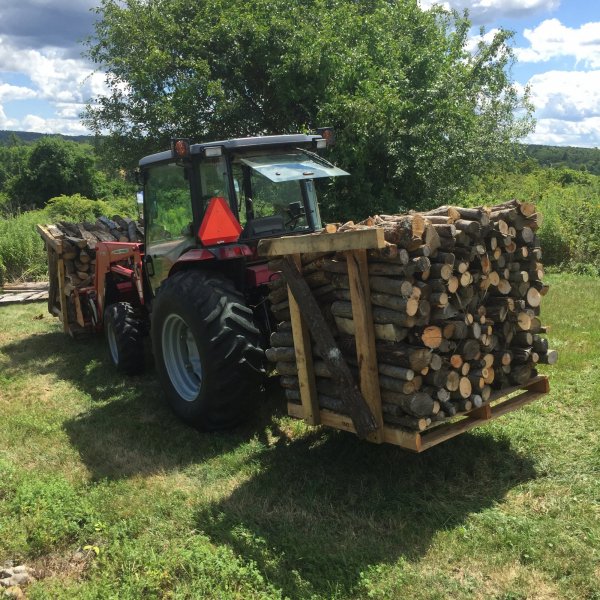

    I end up with a 4'x4'x42" which works out to be 56 cubic feet or just under 1/2 cord. I have had times where I could barely lift a full pallet with green wood and my loader can lift 2500 pounds at the pins. I typically move the pallets with the forks on the 3 point. Once the wood seasons I can lift with the front forks easier but I still prefer the 3 point.

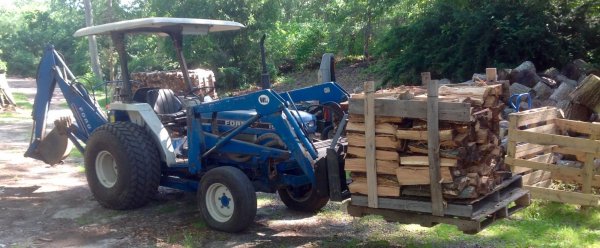

    IMG_0390.JPG Deer Meadow Farm i have always loved those pics.
    My loaders breakout Force is 2790 lbs.
    Lift to full height is only 1100 lbs.
    Most of my skids are 42x42x 44 high
    With green red oak, which is my primary wood, I can't lift it more than a foot or so.
    That's why when I'm stacking a top skid I have to make it shorter.
    I always figured 3 skids to a little over a cord
