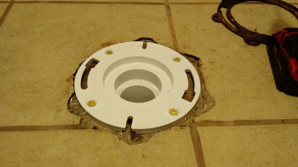

    Good enough. Level and secure. It is totally not the pictured item on the website. No clue why the bolt holes keyways are so goofy, but I worked with what I had. No more rocking!

    The bolt holes are like that so you can adjust the toilet position and not have to worry about where you mount the flange.

    The T-bolt slots ?

    Yeah, they weren't at symmetric offsets, I found it strange. i.e. the center of one slot being 3 o'clock, I would have expected the center of the other to be at 9.
    It also looked wrong to screw the 4 screws in and not have the dead front/ back. To get the most friendly alignment of the T-bolt slots, I had to keep twisting, ending up with what you see here.
    Pretty sure I did it right... but don't like it when things don't make sense to my little brain.

    it allows you to rotate the toilet to get it straight, you should figure the center of the slot, not the end so you can rotate CCW, CW to orientate the toilet
