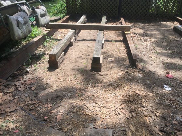

    Anyways here's the start of the deck. We are still trying to do this as cheapest as possible. So I'm recycling some 6x6's that I found on under the interstate bridge in a dump off about 7 years ago... I figured I'd find a use one day... Well nows the time I guess... I figured that I'll stab somethings through those to stabilize them. Then I'm going to run 2x's across the top of the metal I-beams and carriage bolt them together. So that I can run 2x6's across the top. We are ending up going 4 ft less in length than the original deck.
    Any words of advice before it's too late? :D

    from the looks of that right I-beam you're going to have headaches with leveling the whole structure, looks twisted
    This is what happens when people trade the cost of free labor for the price of materials:D
    I'd convince them the scabbing in with the steel is more expensive and kick them over or cut and scrap them and just build a new frame on pavers or poured sonotubes.
    Consider drilling or torching holes in those I-beams yet?

    Yep... But if I want a access to a pool near the house...:confused: ... Cause she doesn't have any one else to do it...:faint:...
    Anyways its leaning a bit but will be up righting it before I get things locked down. I wish I could take them out and do it correctly... But that's not in the bank :makeitrain"... So you seem to be concerned with drilling through the I-Beams? Am I missing something? Is it hard metal? I'm planning only putting a few bolts through each one. Please fill me in...

    Use treated 2x on top of the I beams...drilling through the top flange of the I beam to secure the 2x works fine.
    The 6x6 supported that often on concrete block looks fine for loading. Obviously this structure is not frost free and it will move with frost action in the spring to some degree, whereas the house won't.
    What's the distance between each beam (steel or wood) again? 2'?
    If so using 2x6 deck boards may have a little extra flex to them but it shouldn't be bad.
    The beams maybe be fun to drill through depending on the flange thickness. If you have a torch you may try burning a few holes also. Every 4' should be fine for this.

    Yes roughly 2 ft but the 6x's lesson it by a bit.
    I'll be taking my drill and drill bits down in the next day or so to test it out. I've drilled the beams at work and haven't had much issue...plenty of lube and slow steady does it.
    As far as movement, the main structure was there for 15 years. Can't speak much beyond that information... If it settled it was minimal...

    Just the time and material in drill bits and carriage bolts - depends on how many holes and the material hardness
    Have you run a board/string line level across all three to see how much leveling you'll need to do....
    You obviously had the patience to get the blocks under the 6x6's - so forge on my friend, I'm feeling for you:hair:

    as far as the twisted beam goes, shim the low side as you bolt it
    run your deck boards and only attach on the high side
    DO NOT put a seam on the twisted beam it will be magnified.

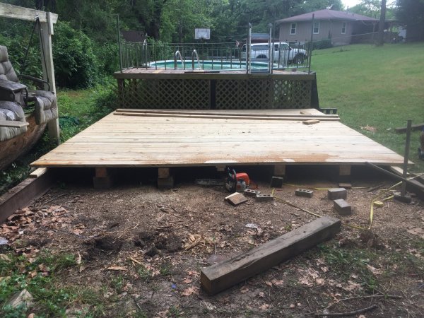

    Well pretty much finished it. Thanks for all the tips guys... I think it turned out pretty good, hopefully it'll hold together...

    Great...now put it to use! :)

    Looks good!
