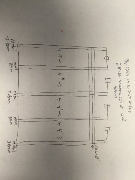

    Here's a drawing...

    So you have three steel beams and two wood beams, and you will be putting new beams in between each? So the distance between beams (new or old) will be 2' rather than the existing 4'?

    ....and the 2"×6" x8' will be the decking material?

    Yes and yes... She's wanting to do it in the least amount as possible. Otherwise I'll be putting money into from my pocket... Unless you all think like decking boards would be suitable for this.

    I think you are on the right path. 4' span for 2x deck boards will result in a lot of deflection and bounce. You should be happy at 2'.

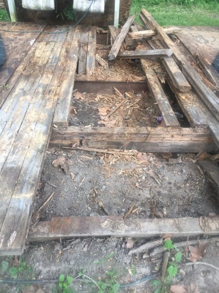

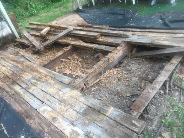

    Here is the degraded stage of the deck. And the underneath beams...
