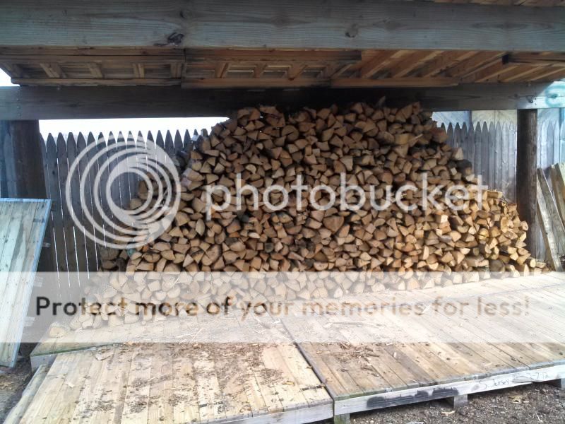

  12. Smokinpiney
    Smokinpiney
    3,811
    20,675
    "South" Jersey
    Started filling her up yesterday! I think im gonna get more in there than i originally thought. :thumbs: Still gonna have to add a section on once it's filled.
    View from the roof aint bad either! I might build a ladder up the side and throw a few lawn chairs up there :drunk:

  13. Loon
    Loon
    6,560
    37,138
    North of the border
    Very nice Smokin :) and the roof view looks like a great spot to watch the world go by ;)

  14. swags
    swags Moderator
    4,455
    13,241
    Very nice, are you going to put anything on the sides to stack against?
  15. Smokinpiney
    Smokinpiney
    3,811
    20,675
    "South" Jersey
    Yea, i havent decided on what im gonna use yet. Either gonna throw a couple 2x4's across the sides and some uprights to stack the ends against. Or i'll just drive some stakes along the sides.

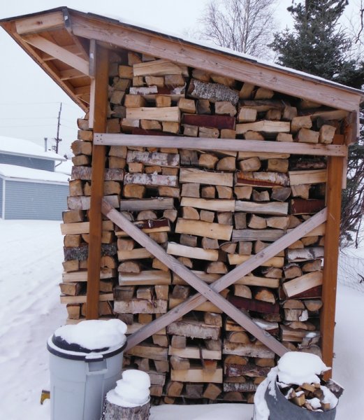

  18. bogydave
    37,220
    Looking good
    I have a "X" on the ends of mine, & cross stacked ends.
    Has been pretty stable, even in a few minor earthquakes
