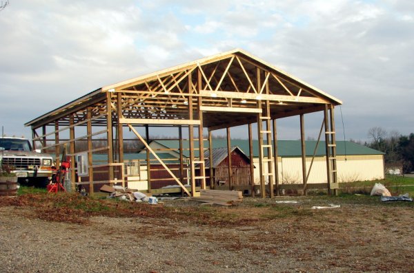

    My garage is 40x40x14... thought instead of attic truss I could build a partial second level (just for storage and stuff) in a 'L' shape on one side and half way across the back. I haven't yet though, now wanting to move out of this place.
    During construction shot. Trusses are just 2x4 bottom chord, 4' oc. 6x6 posts with 2x4 purlins.
    Great info there Farmhand. I really hadn't looked into the finer details of building a pole-building for living use. I've never heard of 3 ply 2x6 columns, are you talking about laminating like 3 2x6s together to form one larger post instead of using a 6x6, and then building the framing into these (as opposed to onto).
