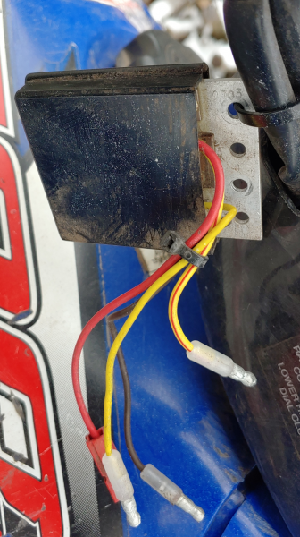

    Here's the one that the repair guy put in up north. My mom was using my ATV and she found some guy, a hack IMHO, that tried to put this rectifier/regulator into it. It's not the stock style, so maybe it would work. IDK, I just know that this one fried a new battery. That tells me that the regulator wasn't working and sent too much voltage to the battery.

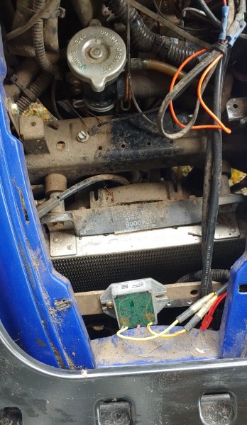

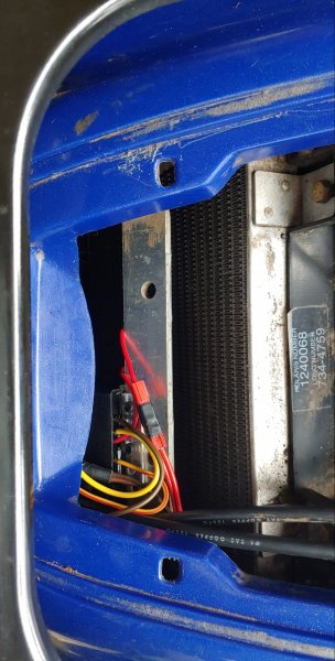

    Here's the stock style. Before I mounted the unit to the frame. Message_1601319184866(1).jpg
    And mounted.. the repair guy up north lost the bolts to mount this. So I found nuts and bolts that worked. Message_1601321726463(1).jpg
