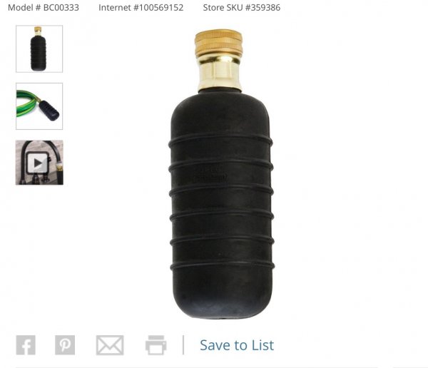

    A few years ago I noticed the kitchen sink slowing to a crawl when draining, so I got one these and used a coil of PEX instead of a garden hose. Attached to the hot tap of a former utility sink location in the basement, started at a clean out directly under the kitchen sink (but down in the basement).
    Years of PO dish washing and who knows what else finally crudded up the pipe. The bladder and PEX combo could not cut a 90° turn tho. But on the straightaways it was great.

    Good option for "goop" in the drain! ^ ^ ^
