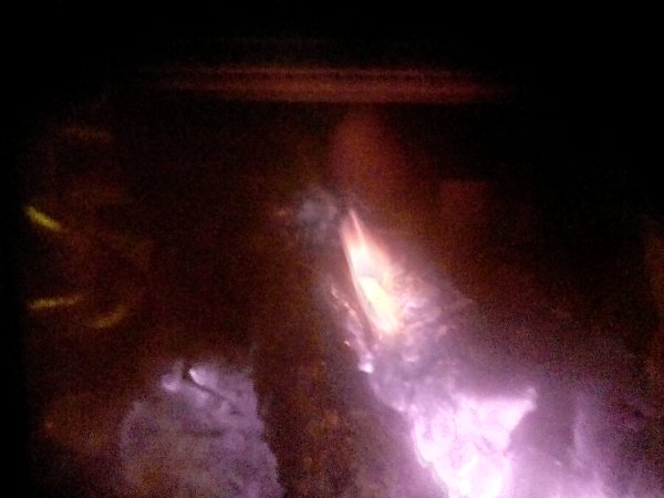

    So, I just tried an almost cold start, similar to what saskwoodburner suggested, and it seemed to work. Whereas the needles were matched to start (mid scale), I now have "split needles", where the STT is showing a little higher on its scale than the flue is on its scale. Here is the current result on a small (and dying) burn:
    Flue
    The effect could be a matter of a dying fire, with a more responsive flue gage than STT gage, though as I type this, they both seem to be holding.
