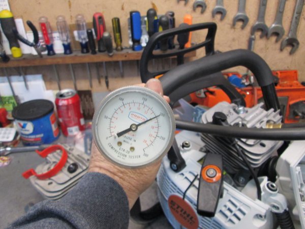

    I just got back from taking the little woman out........it's here birthday. :)
    I'm just now finishing assembling the saw.....
    Yeah Matt.......that's the R&D jug.

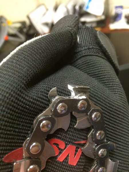

    Been a little busy here Dex, square filed a 108DL .404 RS after grinding away at a new muffler.
    Looking for a box to fit an 066 in, has to travel to Tenn.:dremel:
    My 36" stumpin setup is just about complete !!:yes:
    I see you have been playing with your new chain vise. How do you like it ? Have you been practicing your square filing ? Send me your dull ones if you want, postage on me ........... I still owe you.
