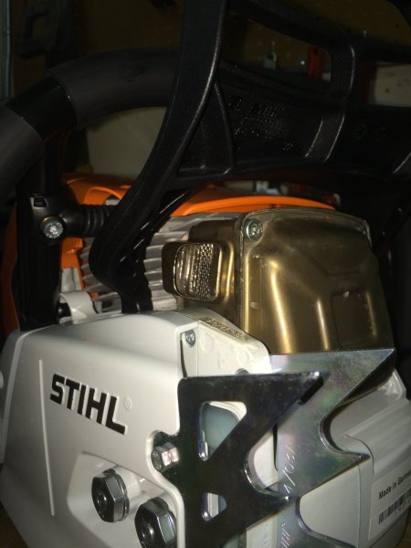

    Probably a stupid question, but I'm guessing there isn't another way to boost compression without lowering the jug?
  6. Mastermind
    Mastermind
    1,257
    5,594
    Tennessee
    A person could weld a popup on top of the piston.......but that create problems of it's own.
  7. MasterMech
    9,648
    26,048
    Greenville County SC
    Pop-up pistons. Two-piece heads. Eliminating the base gasket (which is lowering the jug).
    Cutting the squish band does two major things at once when it is combined with lowering the jug. It shrinks the combustion chamber and increases the effective stroke of the engine. That is, the distance from TDC to exhaust port opening.

    Does this help you, MasterMech??
    Kg461, Drvn4wood, Deacon and 3 others like this.
  12. MasterMech
    9,648
    26,048
    No! Nor does that glory shot of the Tsumara bar....

    I just found 200psi on the 661. :)

    I think Randy just said "BINGO". Randy, did you check the factory WOT before porting? Also, have you checked the WOT after the 200psi? Just curious if it changed. I know my factory 660 4-stroked well around 12800. After you ported it, with the same fuel and ambient conditions, it seemed to raise the WOT 4-stroking an additional 1000rpms!
    Best I remember Porsche said his factory 661 tached out at 13200.
